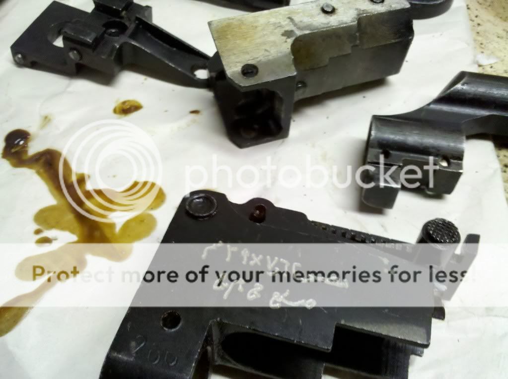

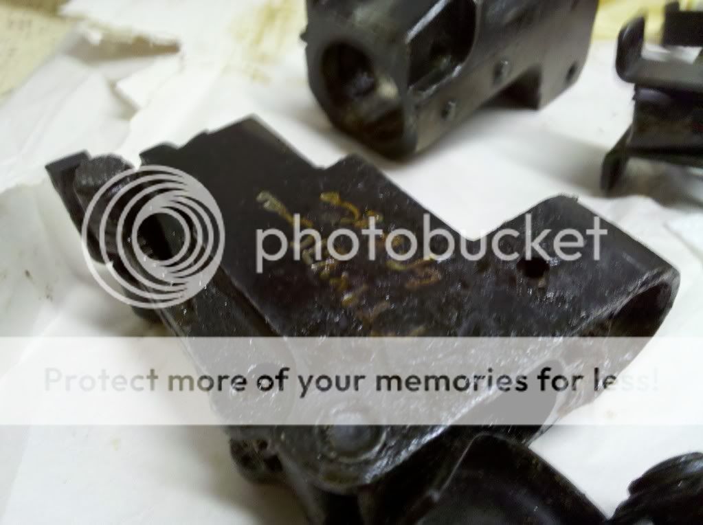

    Heat works it really good. Put it in the oven at about 150 for an hour. But for the small parts I use kerosine and an old tooth brush and Q-Tips and pipe cleaners. Brake cleaner does well too. The kero I let sit over night with the parts soaking. Sometimes you don't need to go that far. The kerosine has never done any harm to the parts. If you look at the galley, there are some pic of my Albanian SKS parts that I worked with the kerosine.

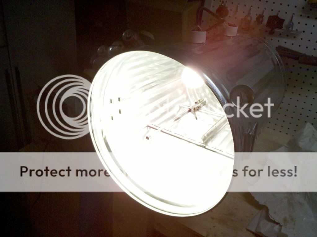

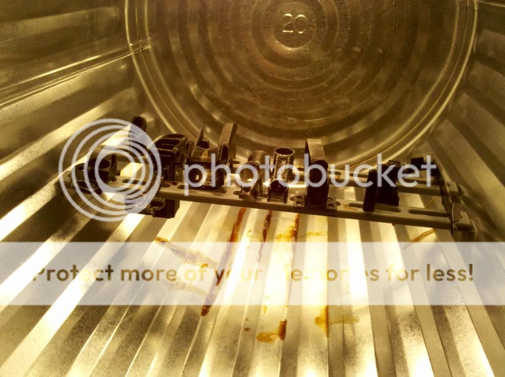

                This is how i do it, most drips off and the rest i wipe away

                    STRAYKILLER, I made one of those a few years back also. People, It works really really good. I made mine so that I can put two cans together (for stocks) and can convert it quickly and easily to make one. I use three 100w light bulbs in it. I made mine more industrial strength than as directed. It is known as the "Easy Bake Garbage Can Oven". It was from on the former surplusrifle.com. Lucky me I had bought there CD's from them before they shut down.
