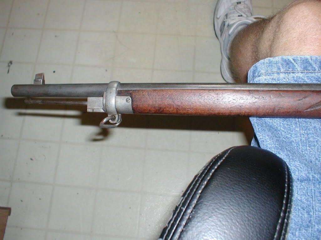

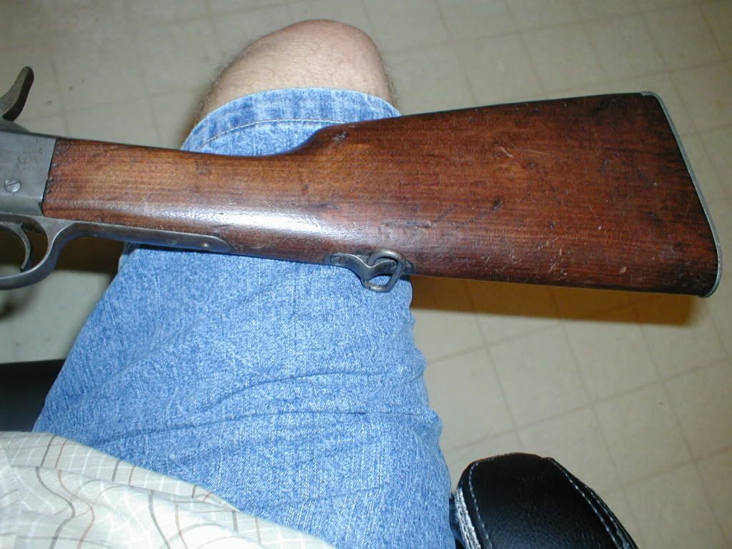

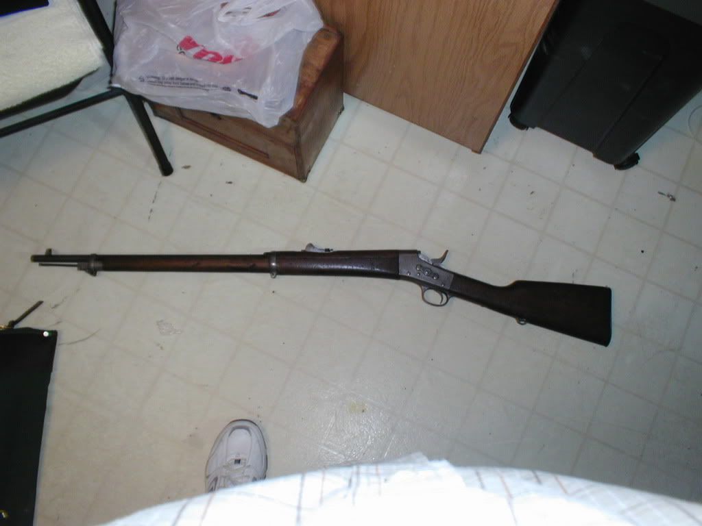

    I've been reading that handloads only should be fired in these. I'm not sure I'll ever ever shoot this but I would like to know more about it. It has this info behind the hammer on the stock tang: REMINGTON ARMS CO. ILION.N.Y.U.S.A. PATENTED OCTR. 22ND 1901. On the barrel in front of the band is CAL. 7 M.M. The rifling looks strong but I haven't even run a patch through it yet. It has a 30 inch barrel. Do we have any resident experts here that can bring me up to speed on this?

            You have a pretty nice specimen --

                Looks like a nice standard South American or Mexican 7mm Remington RB. Probably has no visible serial number.... Neat rifles. I have one and have shot standard SA 7mm through it for years and never seen any evidence of any issues on the fired cases.

                      The capital "U" should be on the barrel bands. They are manufactured with a taper to match the taper of the barrel, and the U stands for "Up", meaning when the butt is resting on the floor and the barrel pointed up, the U should be right side up as well. This is typical for a lot of US rifles having barrel bands.
                      Yours appears to be a 1902 version. The No. 5 Rolling Block was made in 3 distinct variations. The 1897, 1902, and the 1910. The main difference between the three was the extractor (sliding on the '97 and '10, and rotary on the 1902) and the handguard wood and its reinforcement. The patent dates on the upper tang were also slightly different, as well as the caliber marking.
                      I dont believe any of the No. 5's were serialized by Remington. Possibly by the purchasing country.

                            The huge majority of No. 5's are "Mexican".
