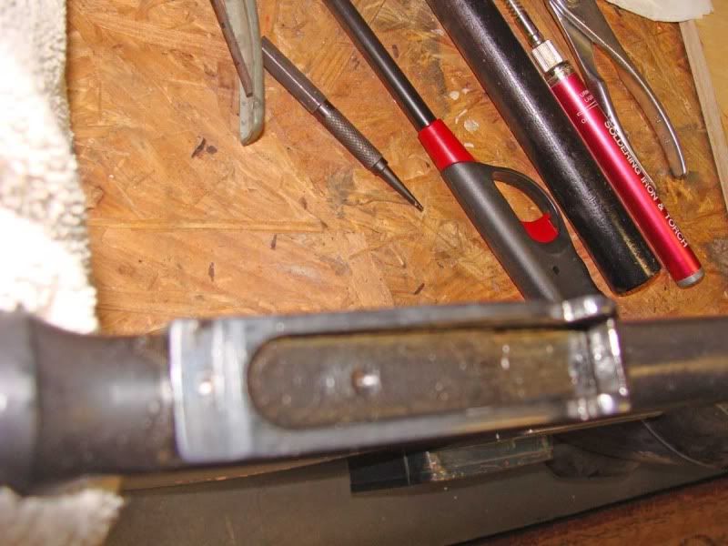

                              OK, so I've got a problem with my rear site mount on a 1936 Tula 91/30. I've pulled the pins, the spring and the rest of it, but I can't get the site mount bracket off no matter what I do to it.
                              I suspect that either: 1) I have not totally drilled out the cut-off screw up on top (I wanted to be careful to not go too deep and how much can 1/4 of a tiny little screw hold anyway?), or 2) There's some solder buried under there that I failed to heat up enough.
                              I'm looking for advice and ideas. Am I not applying my torch properly? Have I missed a second screw?
                              As good as cutting the damn thing off would feel, I don't want to not be able to put it back like it was.

                                Cutting it would take you right into the barrel.
                                It's filled with solder, as you said, or most likely is. You really need to heat it and hit it forward HARD. We're talking wind-up and let swing! They are on there tightly.
