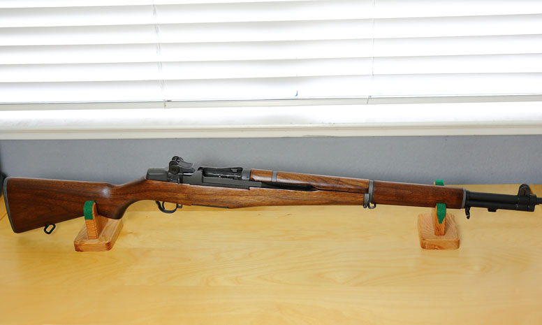

    The CMP special grade .308 comes with reparkerized metal, a re-chambered receiver, new production barrel, and new production wood stocks. I was happy with the overall look of the metal, but the stock left something to be desired. I'm not sure what finish the CMP is applying, but it was very dry looking and lacked overall "pop".
    I read about people having good luck just finishing on top of the existing CMP stain. That saved a lot of work from having to strip the stock first. I ended up applying some leftover stain that I had which has more red pigment in it and then a couple of coats of MilOx. I finished it up with a coat of Tom's 1/3 mix to take down some of the gloss.
    Anyways, here's my new CMP Special .308 Garand:

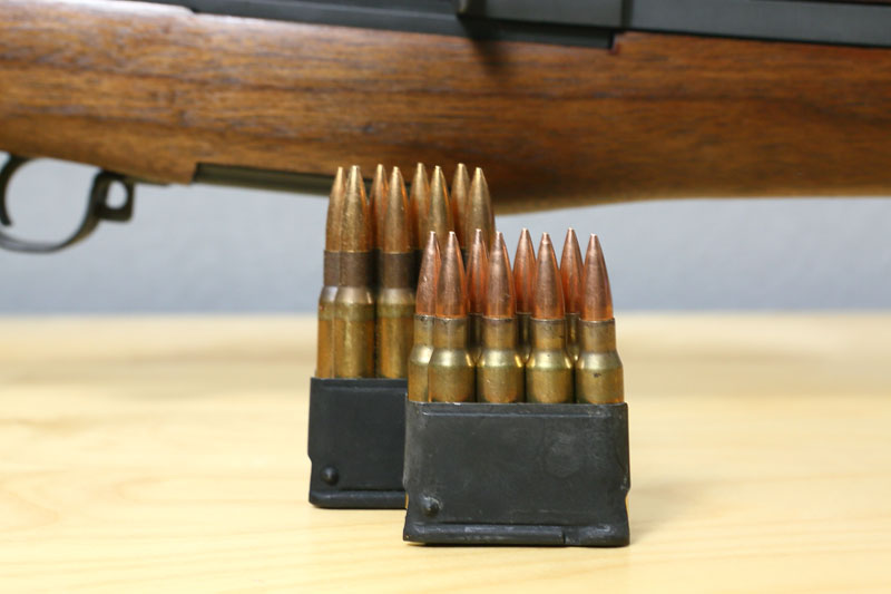

    clipped .308 (front) vs clipped 30-06 (back). Yes you can use normal enbloc clips. Good thing I have a lot of them back from when they were selling clipped HXP in 192 round spam cans (no longer available )

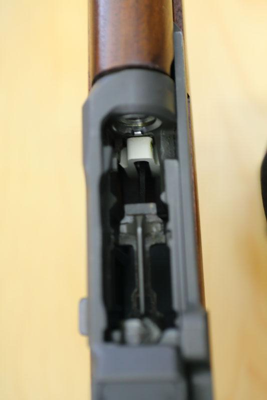

    The CMP installs a plastic block which prevents the loading of the longer 30-06

        Just to clarify nothing was done to the receiver as you don't "rechamber" a receiver as you would with a barrel. In this case a new CBI .308 tube was installed and a plastic block (you already mentioned) to prevent inadvertent insertion of 30-06 ammo.

          I have, or should say I "had" an Arlington Ordnance .308 conversion before my kid talked me out of it. It has a Dillon muzzle brake on it, so the recoil is like shooting a .243, tack driver too. I never noticed a block in the mag well, I'll have to have him send me a pic of it to see.
          Tom's 1/3 Mix will make a big improvement on that stock if you don't want the trouble of a strip and re-finish.
