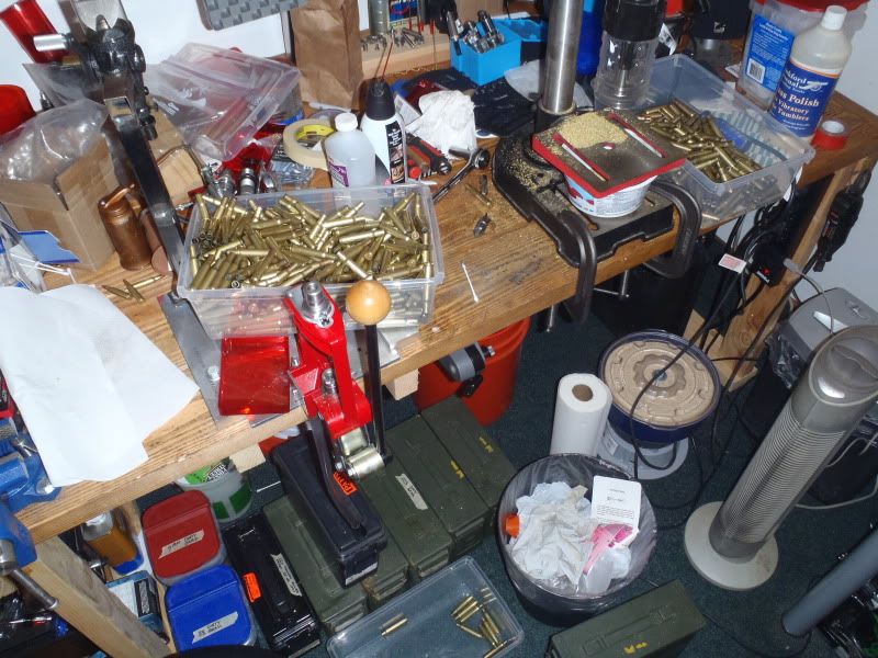

    Here is a pic of the whole setup, kinda.

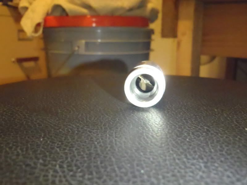

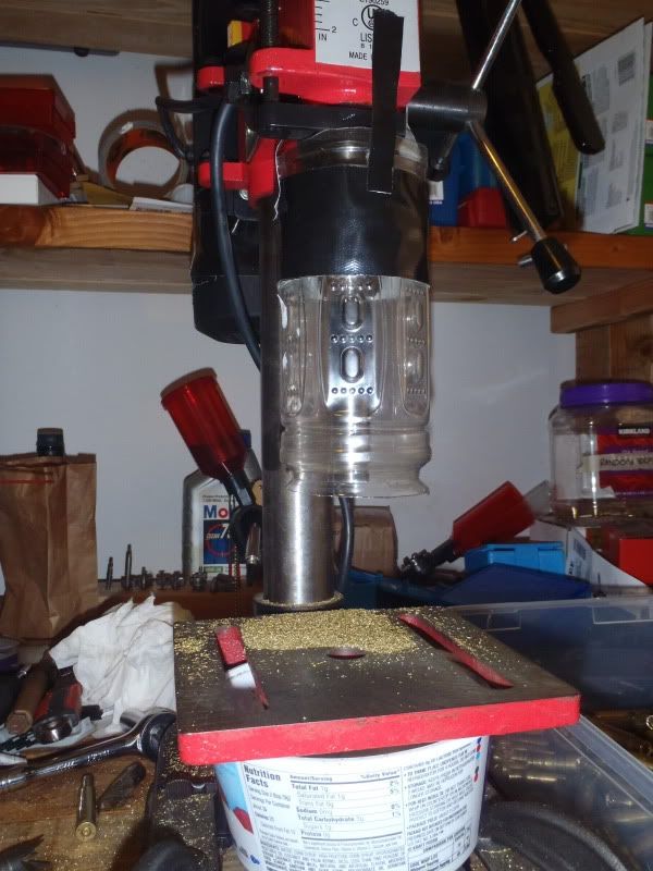

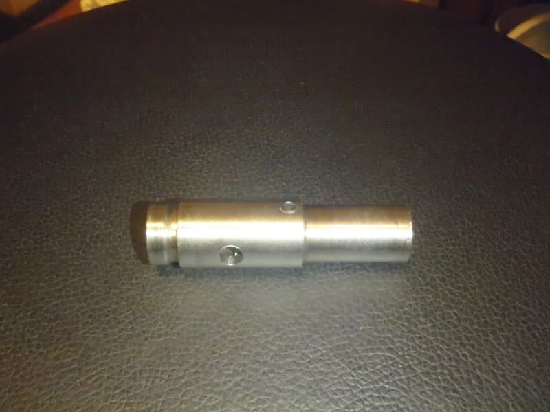

    After the first sizing, approx. 6mm of brass must be trimmed off to bring the brass close to spec. I am using my own homebrewed version of a possum hollow trimmer in my drill press. I can only do 30~ pieces of brass at a time or the cutter will get too hot and not cut as efficiently, and this is a low buck setup. As a result, I am willing to take my time. I come back to it every so often and do a few more.
    I made a chip deflector out of a couple gatorade type bottles to contain all the brass coming out of this thing, spinning at 2000 rpm it flings brass shavings everywhere, and in great quantity.

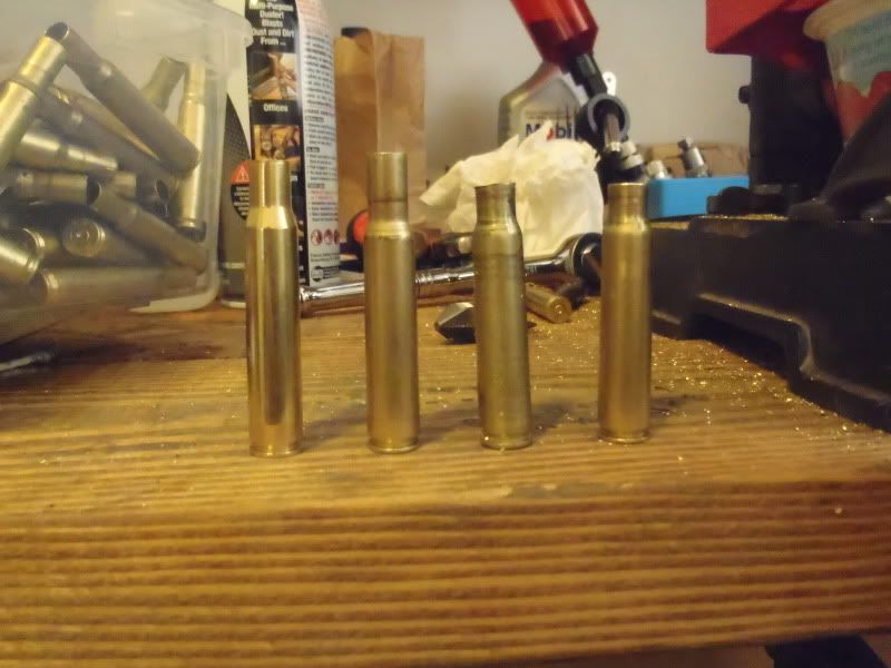

    Here is a pic of how the brass looks through the process. I will update this with additional pics once i get it all prepped, and loaded
    Left to right: Clean 30-06, lubed and sized, trimmed, chamfered.
