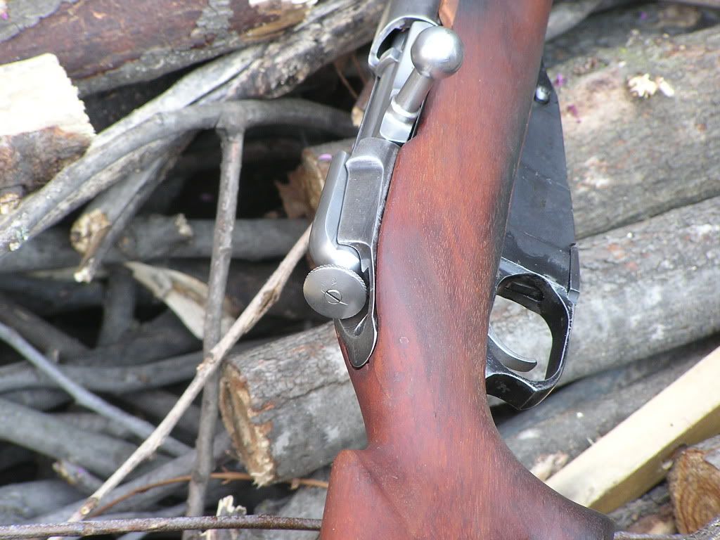

    Now, as it turns out, it appears that burning the wood in a fire had an effect on the wood. Who knew? ;-) Apparently the wood became a bit brittle. So, after maybe 40 or so rounds, I noticed the crack. There are cracks just like this on many other Mosins, and some of my Finns have a repair just like this in the same place.
    First, I used a pair of snap ring pliers and a couple strips of scrap maple to spread the crack. I forced in glue, then with the pliers I opened/closed, opened/closed the crack until glue came out the other side. Then I clamped it.
    The next day I drilled two holes deep through the cracked piece, through and deep into the solid part of the stock at two different angles in an effort to prevent further cracking. In a couple days when the time opens up, I'll slice off the two dowels, sand it lightly, and put on some more BLO. I also hogged out the stock at the tang in a further effort to prevent future cracks. Whether it will be successful remains to be seen.

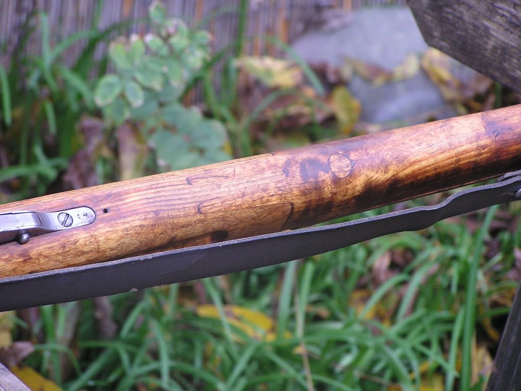

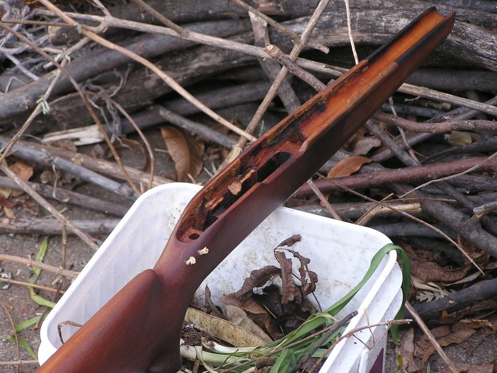

    Here is a pic of the repair. I put it here so folks can see the charred insides. During that range trip, WickedPete noticed that my interruptor was not performing as smoothly as it might be, so when I had it apart, I took out some more wood there. Now it is smooth. You can see the color of the wood there, sort of tanned. When I do the BLO coat, I'll put some in that now-unfinished area.

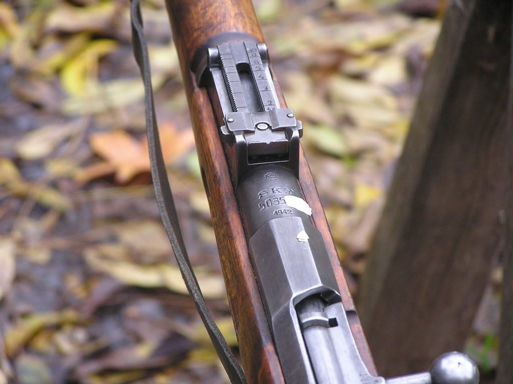

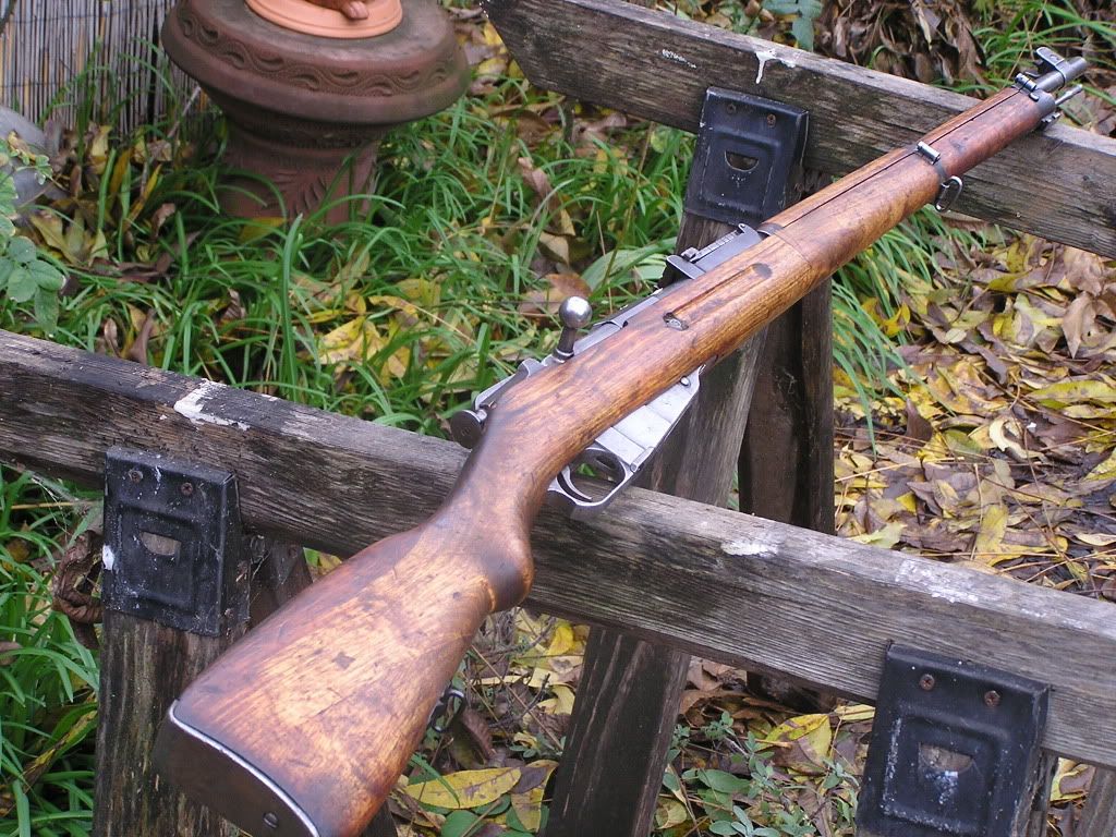

    Here is one of my Finns with a similar repair, a 1942 Sako Sk.Y m39:
    This Sk.Y marked rifle is not marked SA, meaning it remained in the Civil Guard and was not transferred the Army. It has other repairs as well, showing the Finns patched 'em up and sent 'em back to guard the Home Front from the Soviets, using wood that may have been marginal as far as cosmetics is concerned.

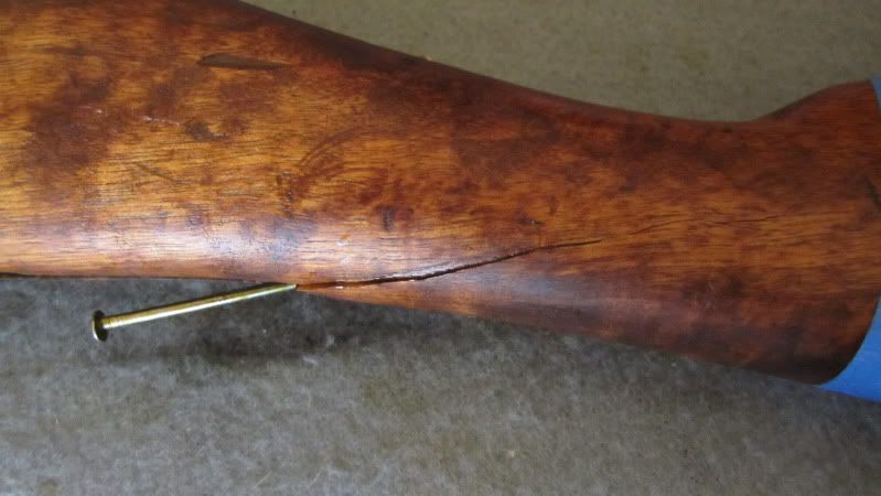

        Last year I bought a Finnish M/28-30 that ended up being damaged in shipment and I epoxied a threaded brass rod into the wrist to repair the crack.
        Here is a pic of the crack:
        Here is a write up I did on how I made the repair:

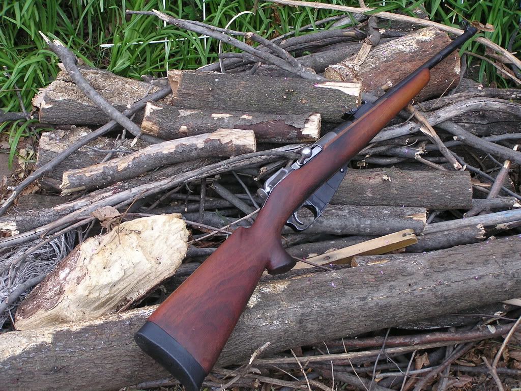

            pics of completed repair project
            I'm slow. But it's finished, and it came out OK.
            First, before I put it back together, I thought I'd show the underside repairs from the fire:
            Here is a close up of the repair:
            Here is the whole rifle:
            Old guys just want to have fun...
