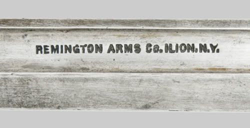

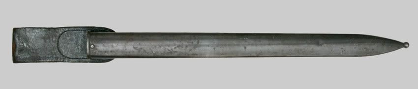

                  These Remingtons had both short and long bayonets, straight and very much like the bayonet for a US Krag rifle. I suspect the Mexicans used the earlier long model, but can't prove it. They will be marked Remington and unfortunately that jacks the price up! One more thing to search for.....

                        Definitely a military rollingblock. This is the long version of what went on the end of it.
                        worldbayonets.comFollow us on Facebook! facebook.com/worldbayonets
