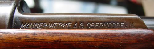

                          That bolt is probably not original to the gun. In fact it's probably a bent GEW98 bolt. Definitely not a K98K bolt as it does not have the proper profile to be a factory bent bolt such as the K98K bolts had. The rifle is a pre war (WWII) sporter based on the commercial proofs. The bolt should have commercial proofs similar to the proofs on the barrel. since it does not it's a replacement bolt.
                          Commercial proofed bolt markings:
                          Are there and side wall markings on the left side of the receiver such as these?
                          Most likely the barreled action was brought back from WWII by a soldier and the bolt was taken from him during transport. Another bolt was given to him upon arrival here in the states. They were not real concerned keeping them matching.
                          There should also be a serial number on the receiver. Maybe I'm missing it but the photos don't seem to show one. Usually there are proofs near the SN too.
                          Like this:

                            I'll be home in 2.5 hours and I'll take a 2nd look.
                            Originally posted by Kestryll
                            ..you're kind of a sad excuse for an attorney...
                            Originally posted by Libertarian777
                            ...Don't pick either side....
                              2shotjoe
                              • 26526
                              nope, just some symboles.
