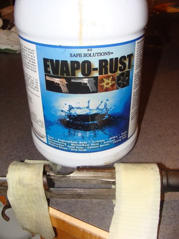

    Another product I have used is Evaporust http://www.evaporust.com/evaporust.html
    It will remove blued finish as well as rust, but won't affect plated finishes like nickel.
    After you remove the rust, if you want to polish the metal I use Flitz http://www.flitz.com/p-16-flitz-polish-paste.aspx
    It is non-abrasive and works well.
    I used Evaporust and Flitz on this rusty Gewehr 98 receiver.
