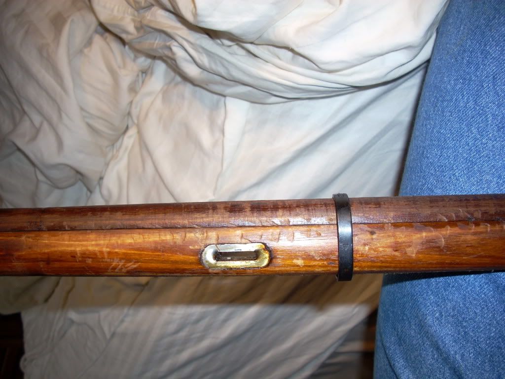

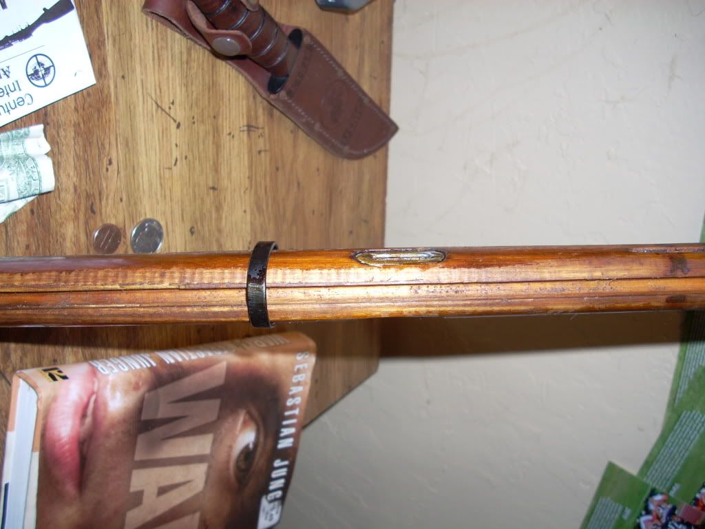

    got my 91/30 today. LOVE it. took it apart right away and learned it all and cleaned the cosmo out. Learned to take down the bolt.. took a while... took apart wood from barrel.... put barrel back together... AND THEN i TRIED putting the barrel bands on aand.. well, the pressure was so tight..something was wrong because they werent going BACK On easily AT ALLL and was all bad that It slipped fast and quickly took off the "holder" for the bands on the barrel.. ok.. so i replace the band with black rubber tape... AND then try putting the first band on to go to the spot closest to the 100-900 m sight.. had to use a hammer and screw driver... my wood IS ALL MESSED UP. i cried from frustration. never getting another mosin nagant. took me literally from 8pm to 1am to finish my "simple take down" process. Even though I love mine and bolt is so smoooth i can eat off it, Im sticking with this C&R only....

      Holy wow. If something doesn't want to go, force it? All you had to do was spread the bands a tiny bit with a screwdriver or snap ring pliers. How bad is it? Let's see some pics. You may be able to smooth out the shellac with some denatured alcohol.

                i thiiink its the shellac that got all scuffed. puttin pics up in a sec

                      In the last picture, are those gouges on the stock (lower part) your work?
                        thats 10 minuets worth of damage on a good day in Stalingrad.
                          NYY
                          • 1877
                          Yes those gouges are my work.... and more like 30 minutes my friend...

                              It's actually not too bad. You can fix the shellac and steam out the dents if you're unhappy with it.
