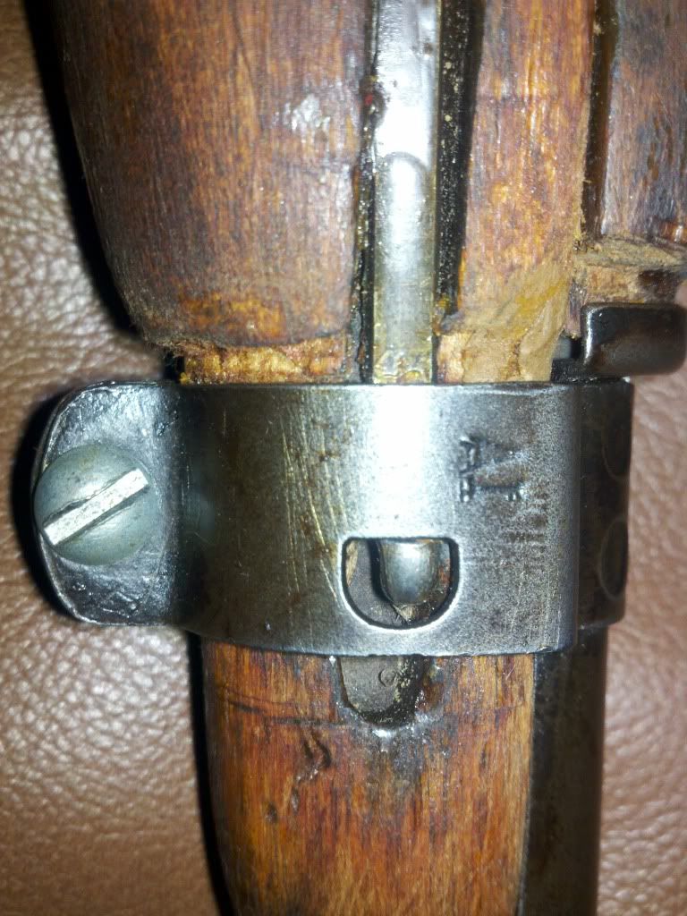

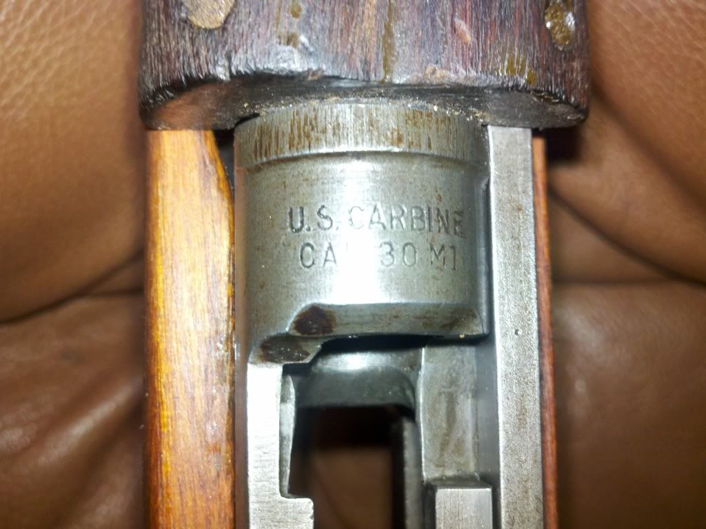

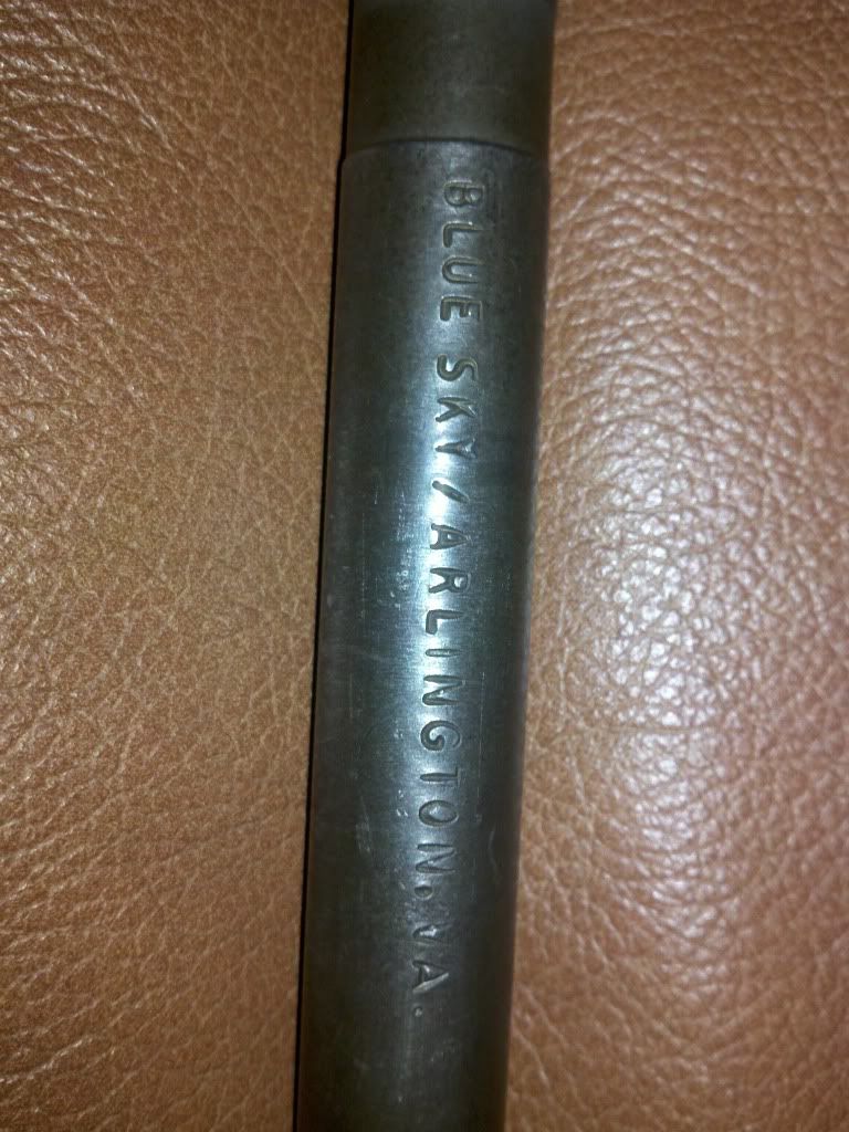

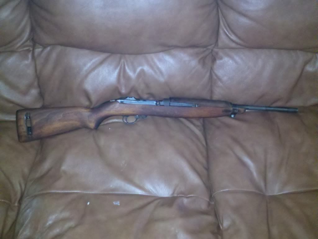

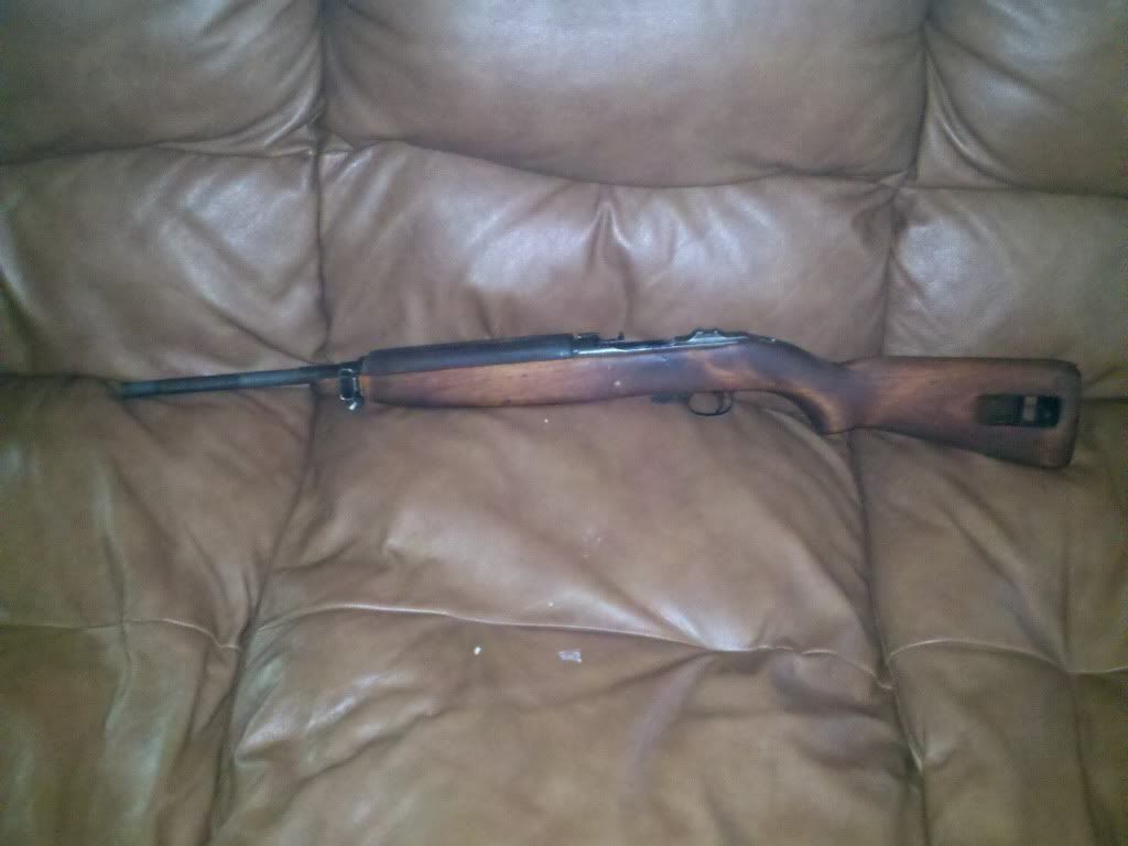

    hello i just got this from a friend don't know anything about it but i think i got some good pics. plz anyone that know feel free to chime in. also i would like to know its worth. i know its missing both sights but don't know what else.

    very nice. your missing the oiler bottle that doubles as the rear sling attachment. not sure how much it would be worth but i know its would be worth resorting for sure.

      Your carbine is one of 413,017 made by National Postal Meter of Rochester, NY during World War II. National Postal Meter produced the highest overall quality M1 carbines according to carbine author Larry Ruth.
      The Blue Sky import mark means it was most likely imported from Korea.

      It looks like someone cut off the bayonet lug and installed a non-USGI screw on the front (barrel) band. You can get a USGI replacement from http://www.billricca.com/carbine.htm (item W2)
      Your carbine has a "potbelly" birch stock that was commonly used after World War II. It is perfectly usable for a shooter. If you prefer a walnut World War II-style stock the CMP sells new replacement walnut stocks http://thecmp.org/stocksets.htm

        See pic #4 for oiler.

            Blue Sky was famous for stamping the barrel so hard that it bent. Check your barrel before you start spending any money on the carbine.

              The occurrence of the bent barrel wasn't as common as people proclaim, so don't worry too much about it.

              Yours would probably be in the 400 range where it stands.

                    Probably not, most parts are not that expensive. it's worth about 400-500 in its current condition if it will fire safely. Blue sky was not the most popular importer of Carbines and Garands. Allot of people try to avoid them.

                          My reference have that serial number built in summer of 1943

                            Based on my experience with a Blue Sky import Garand, I'd imagine the bore is fugly.

                              I looked down the barrel and it looks clean inside. I think it looks fine
