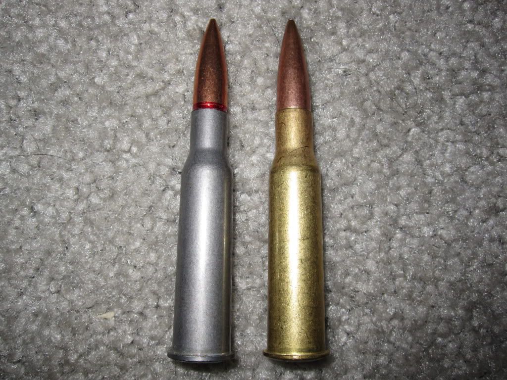

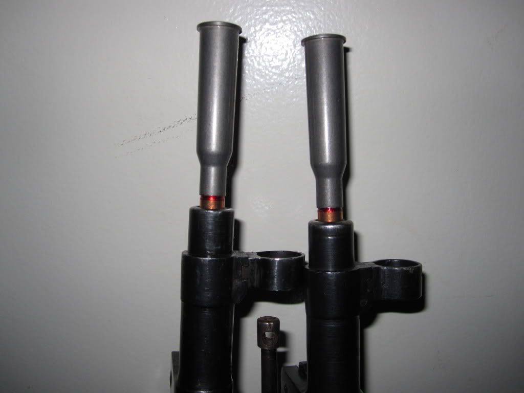

                            This thread made me think of my M44s. I've never checked them. I see rifling to the end of the barrel. It's worn like the second image, not completely smooth.
                            Where I'm confused is with the ammo I used. At first I used the Hungarian surplus to gauge the muzzle. It looked alright. Then I used What I think is Yugo? And It looked like crap...ate the round. Why such a huge difference? I can see rifling to the end on both barrels.

                              That's quite puzzling that both ammunition types, Hungarian and Yugoslavian, exhibit different levels of penetration in the barrel. I wonder if non-surplus 7.62x54 would provide an even different result.
