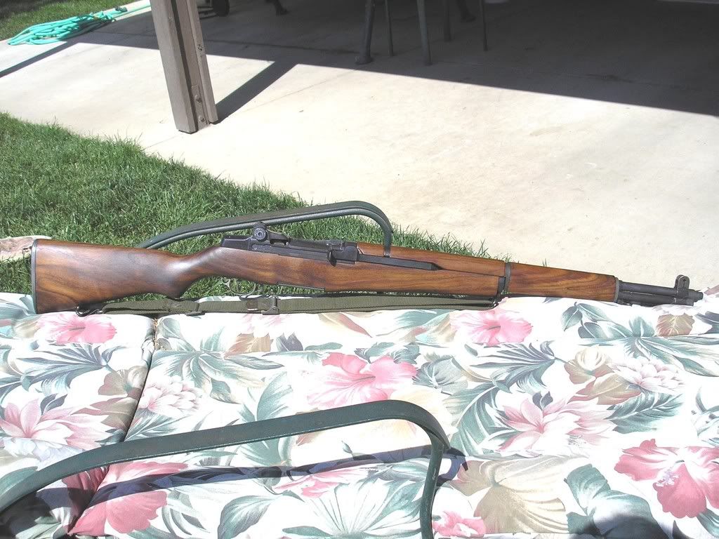

                            I had all of the major parts for an M1 laying about so I bought a reciever from the CMP along with a stock set. Dean's Gun Restorations barreled it up and reparked it. Even with having the barrel, bolt, op rod, gas cylinder, and trigger group parts I still ended up with about an additional 350 into it. The whole thing probably cost in the range of 550. It was fun and turned out nice but it wasn't a cost savings by any means.
                            I got the parts from Century when they abandoned their M1 rifle project. They were in nice condition and cheap!
