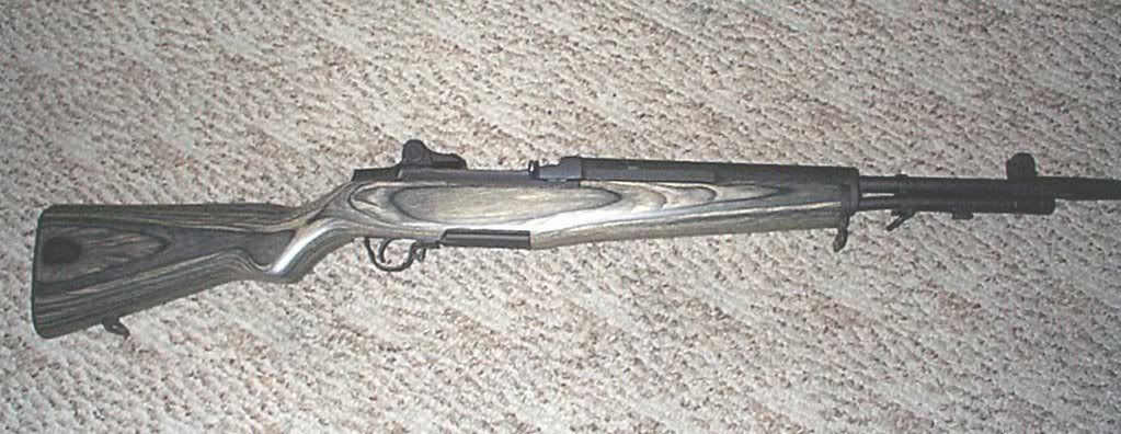

                      I had an old "Blue Sky" re-import years ago that had a worn out barrel, so I had it built into the Tanker below. It's still a .30-06 and it has quite the bark but has been 100% reliable for me.
