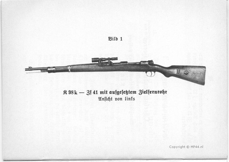

                          From: http://www.wehrmacht-awards.com/foru...=344231&page=2

                            Very cool photos.
