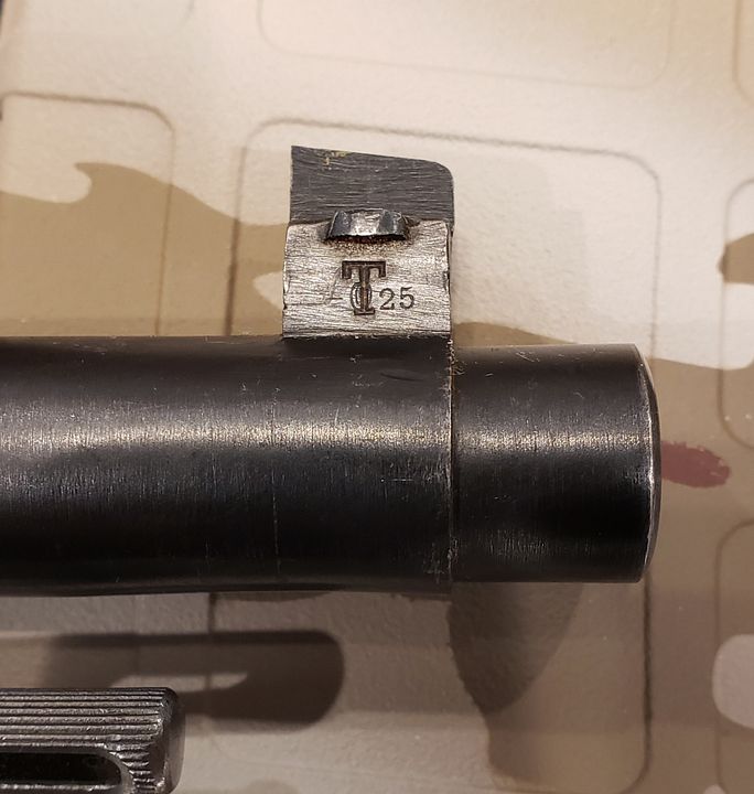

    Some m/38's had their muzzles threaded for a blank firing attachment. These rifles were given the model designation m/38B. The "B" indicating use with the BFA.

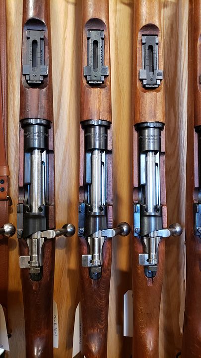

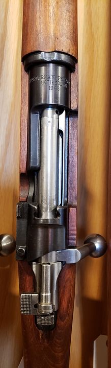

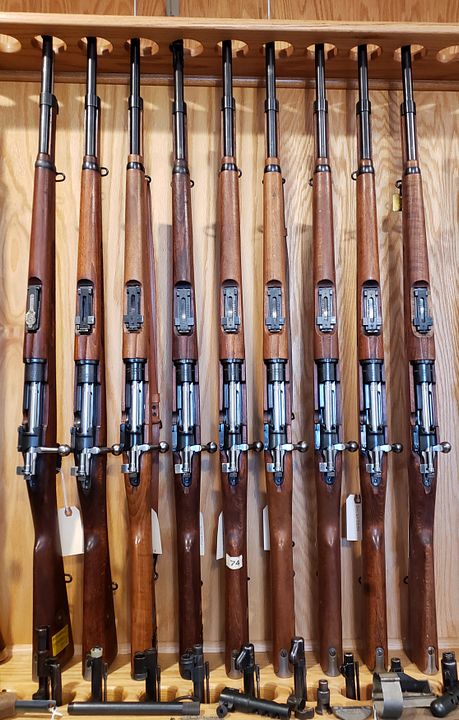

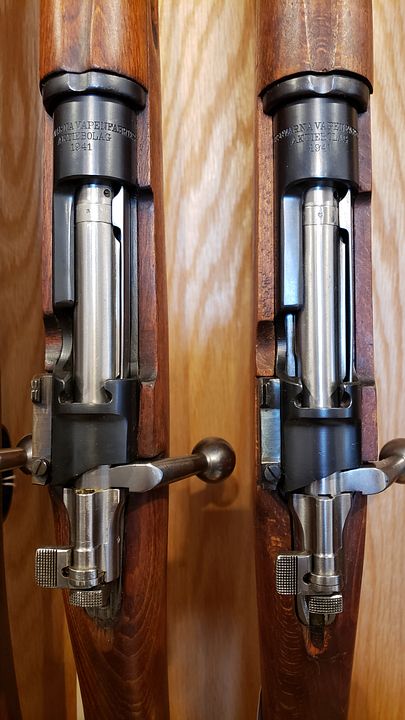

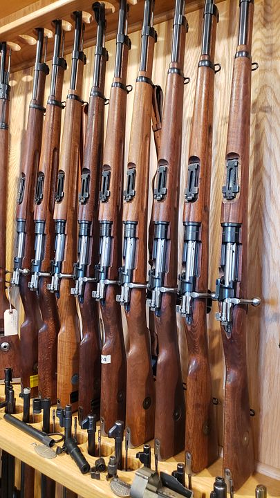

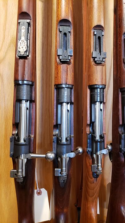

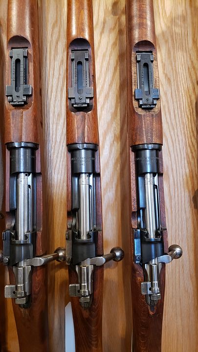

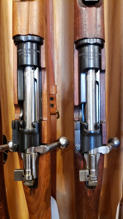

    I have nine Swedish m/38 rifles in my collection. Seven purpose built by Husqvarna. two made in 1941, two made in 1942, one made in 1943 and two made in 1944
    I have two Carl Gustafs Stads converted rifles one dated 1915 and the other dated 1901.
    If you have a Swedish m/38 please feel free to post pic's of your rifle here. It's always good to see what other guys have!
    Pic's.

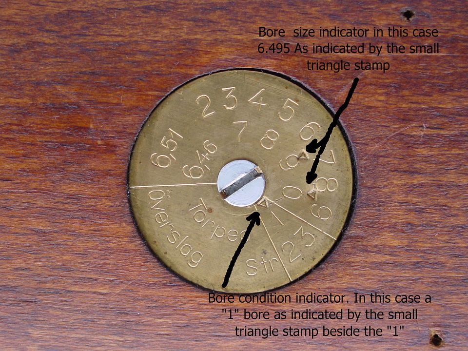

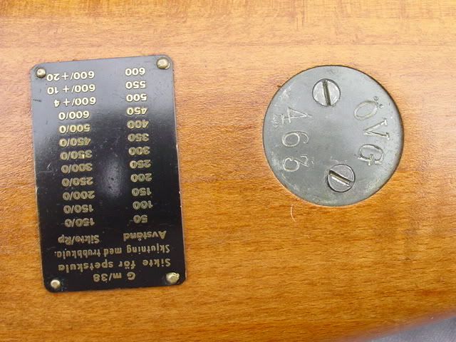

    M/38 range plate and bore disc pic.
    Bore disc translation. If there is no mark above the 1,2 or 3 that indicated a new bore. If, during an inspection a bore condition was found to be over a "3" the barrel was replaced and a new bore disc installed on the rifle.
    A exceedingly few m/38 rifles had unit discs substituted for their bore condition disc. The below pic is of the unit disc on one of my 1944 dated M/38 rifles. "OVG" is the unit abbreviation for the "Goteborg naval dockyard". the number is the rack number.
    The range data plate is mounted upside down on the rifles so when in the shooting position and looks over the stock the shooter sees the plate right side up.

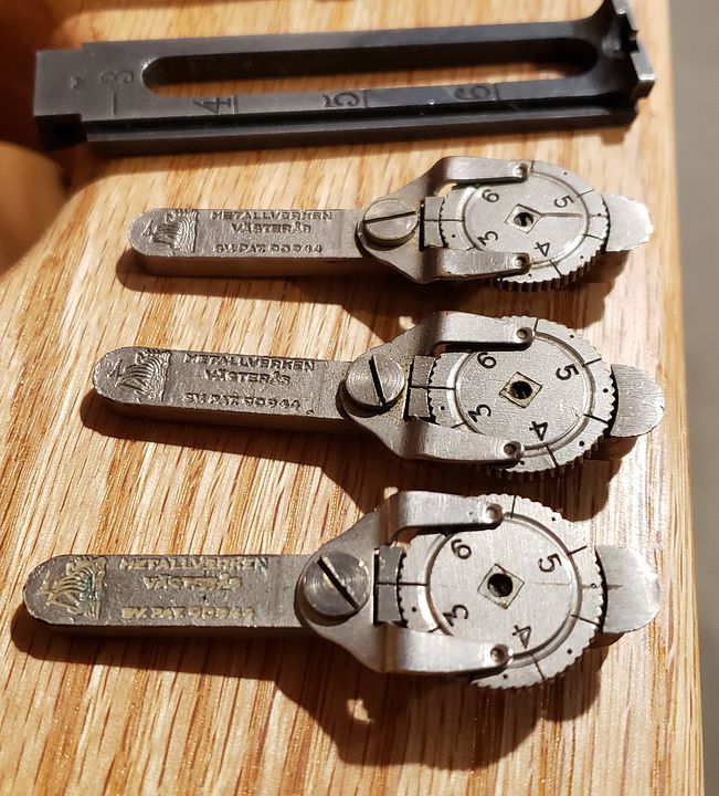

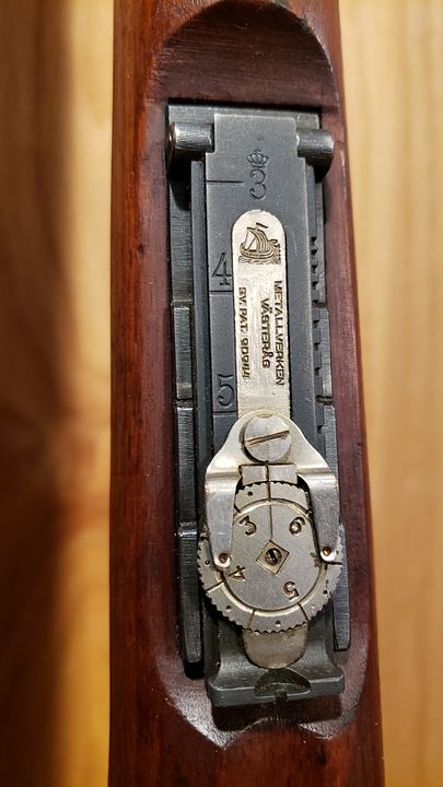

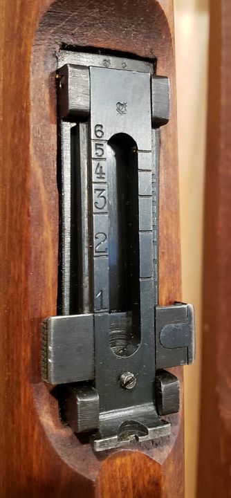

        whats up with the dial on the leaf site?
        What are your kids going to do with all your rifles: )
        Beans and Bullets
          SVT-40
          • 12894
          The sight on the 1915 dated m/38 Carl Gustafs converted short rifle is a Vasteras micrometer sight insert. It replaced the standard sight slider for adjusting the rear sight height for different ranges. This particular rifle being a converted m/96 apparently kept it's Vasteras sight through the conversion process.
          This is a early type Vasteras insert which can only be adjusted from 250 meters to 600 meters.
          These and other types of micrometer rear sights were installed on Swedish Mauser rifles.
          The micrometer sights allowed for more precise aiming.
          Pic of the Vasteras sight on the 1915 m/38, as well as three extra uninstalled Vasteras micrometer sights.
          As for what will become of my collection. My son will get it. He's a collector also. But in the future I'll probably sell off duplicates including some of these rifles.

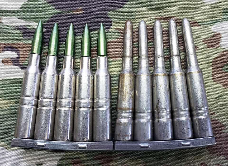

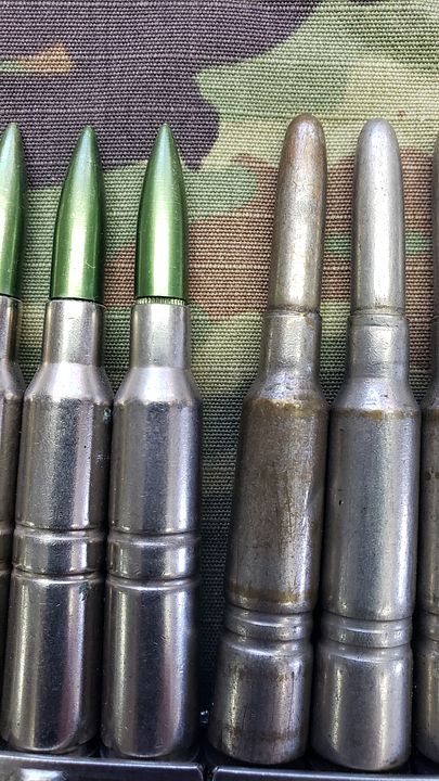

          In order to discuss sights on the Swedish m/38 short rifle as well as all other Swedish Mauser rifles we first have to discuss Swedish 6.5x55mm ammunition.
          When first designed the Swedish Mauser m/94 Carbines and m/96 long rifles were designed to shoot the Swedish m/94 ammunition.
          The m/94 6.5x55mm ammunition was adopted in 1894 along with the m/94 carbine. The ammunition was developed by a joint commission between the Sweden and Norway. The Norwegians adopted it for use in their Krag Jorgensen rifle.
          The ammo had a blunt "ogival" 156 grain round nose bullet. This round nose heavy bullet was typical of similar bullets being used in other Mauser cartridges at the time.
          This round served Sweden until 1941 when Sweden adopted their m/41 cartridge. The m/41 cartridge had a much more modern bullet, which had a boat tailed 139 grained spitzer torped "torpedo" style.
          Oddly this round was developed by Norway in 1925, but it took the Swede's until 1941 to adopt and begin manufacture of this more modern and effective cartridge / bullet combination.
          Below are pic's of dummy m/94 156 grain cartridges as well as the m/41 139 grain "Torped" cartridges in stripper clips.
          Since the Swede's had many millions of rounds of m/94 ammunition when they adopted the m/41 cartridge, as well as over a hundred thousand rifles and carbines with sights calibrated to the m/94 ammunition it was decided to leave the sights alone and simply place a range plate or decal on them so soldiers could compensate for the difference in bullet impacts at longer ranges.

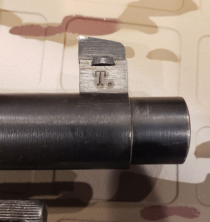

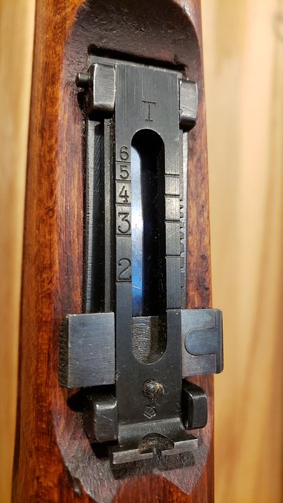

          Early m/38 short rifles many were equipped with sights for the older m/94 ammo. Later production pieces had new rear sights marked with a large "T" to designate they were calibrated for use with the newer m/41 ammunition.
          Pic of a early m/38 rear sight calibrated for the m/94 ammo. They have ranges marked 100 to 600 meters.
          Pic of the later "T" marked m/38 rear sight calibrated for the m/41 ammo. this sight is marked 200 to 600 meters
          When the new "T" marked sights would be installed on m/38 rifles during a arsenal rebuild the armorer would also stamp a large "T" on the right side of the front sight to show the rifle had been calibrated for the new ammo. Different armories across Sweden had different stamps with different fonts. Two different "T" stamps on two of my m/38's

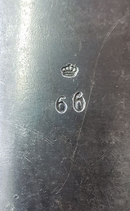

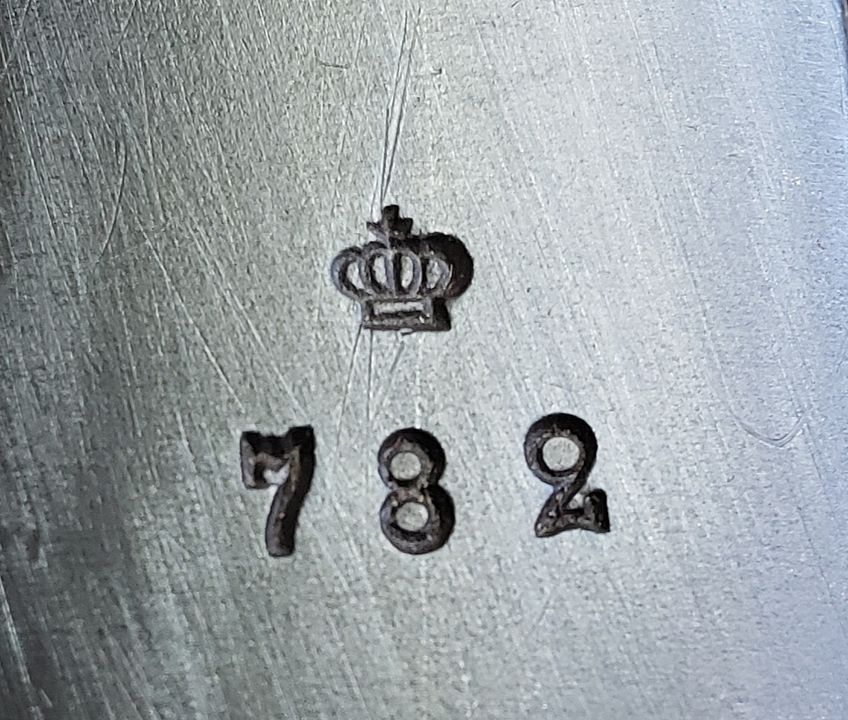

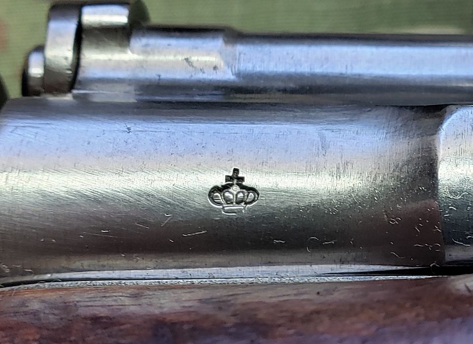

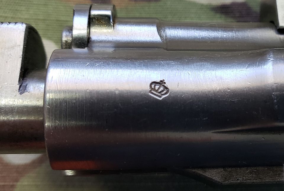

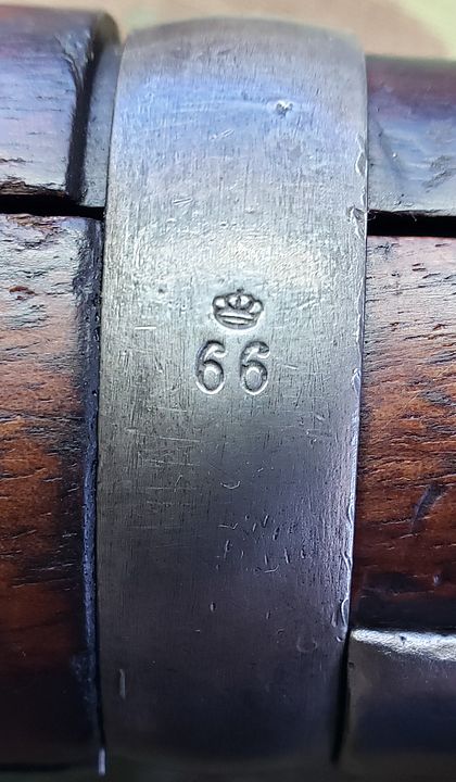

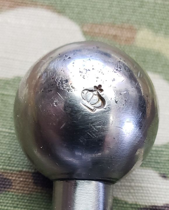

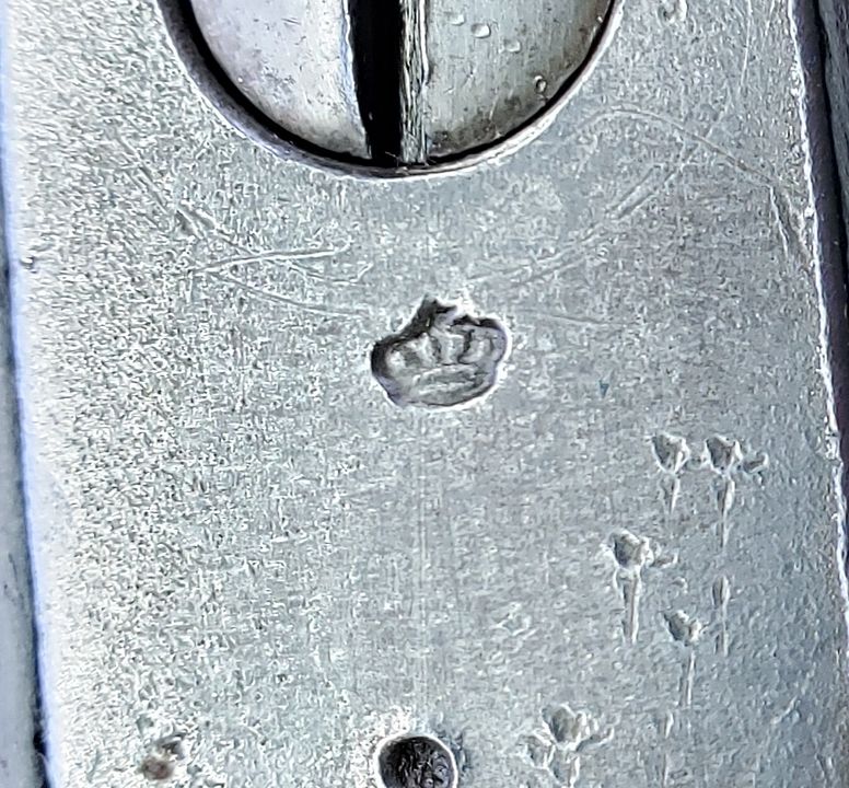

            In some of my photos you may have noticed little "crown" stampings on various parts of the rifles. These marks are proof marks indicating the individual part was inspected and passed inspection.
            Looking closely at the crown proof marks you may have noticed that most seem to be tilted to one side. These tilted crown proof marks indicate the part was made and proofed at Husqvarna.
            There were three different manufacturers of Swedish Mauser's and Swedish Mauser parts.
            Husqvarna, as I mentioned, Mauser and Carl Gustafs. Each had their own style of crown proof mark. The Mauser crown has a rounded bottom and the Carl Gustafs crown has a flat bottom.
            Knowing which proof belongs to what manufacturer is important as it's good to know when trying to verify if a particular rifle is "all matching parts". In that line most Swedish Mauser rifles had the last two or three numbers of it's serial number stamped into most of it's parts so that is usually a good indicator.
            However sometimes during a arsenal refurbishment parts from a different manufacturer were used and the part restamped with the last two or three numbers of the serial number. This is most often found when Carl Gustafs refurbished Mauser or Husqvarna made rifles or carbines.

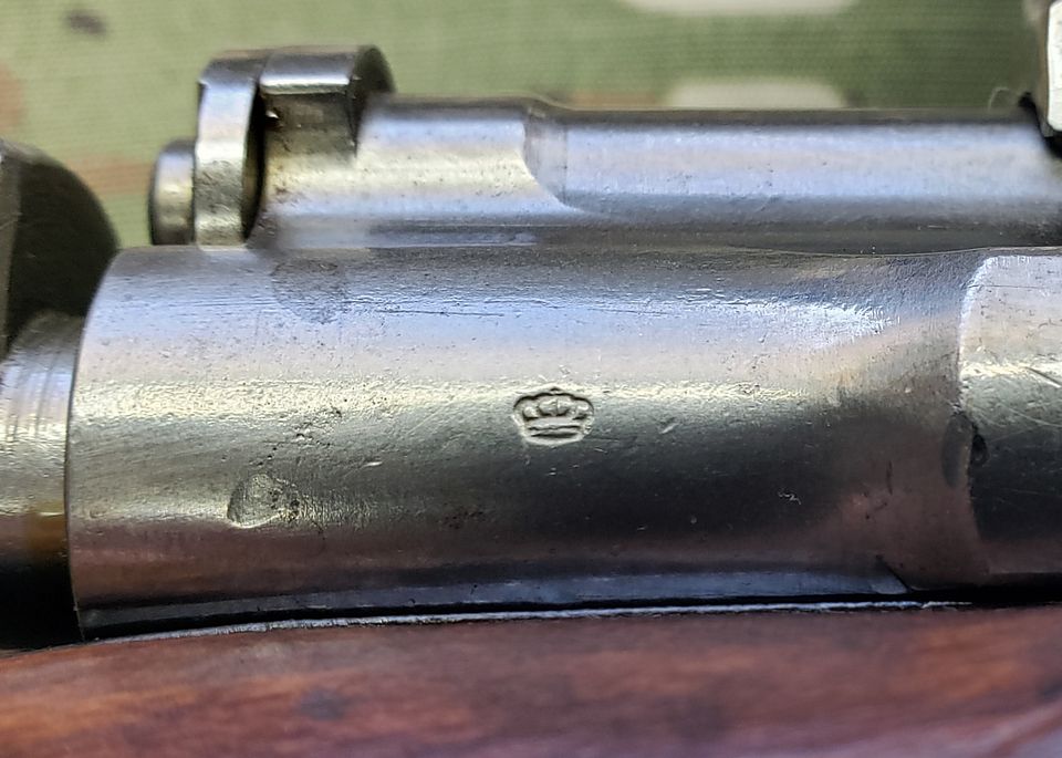

            So here are some pic's of the different styles of crown proofs.
            Mauser Round bottom crown proof.
            Carl Gustafs flat bottom crown proof.
            Husqvarna tilted crown proof.
            All three on the same part, the bolt sleeve.
            Mauser
            Carl Gustafs.
            Husqvarna.
            Poke'm with a stick!

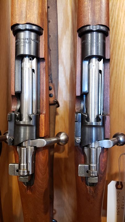

                I've got 5 M38's, including two of the Husqvarnas...sweet shooting rifles to be sure.
                The Huskys

                  Originally posted by SVT-40
                  I like the square front sight/"U" rear sight much better than the barleycorn "V" sight on most Mausers.
                    Mustang
                    • Aug 2007
                    • 5050
                    Great rifles and great information, SVT!

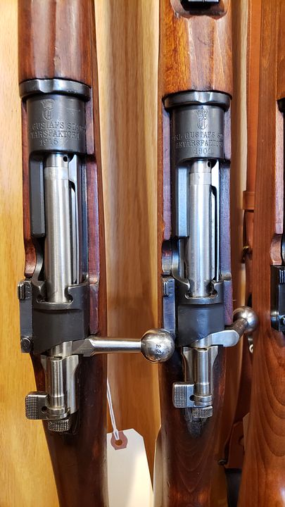

                      SVT-40
                      • 12894
                      Nice m/38's!
                      Is the top m/38 conversion a 1915 Carl Gustafs? It looks like it has a maple stock. The maple stocks were only used for a short time in 1915 on original m/96 long rifles.
                        Mustang
                        • Aug 2007
                        • 5050
                        Nice m/38's!
                        As a matter of fact, it is. Good catch!
                          Mustang
                          • Aug 2007
                          • 5050
                          One of my other M38's is also a 1915...the second one down from the top.
                            Mustang
                            • Aug 2007
                            • 5050
                            I forgot about this one...so I guess I've actually got 6...

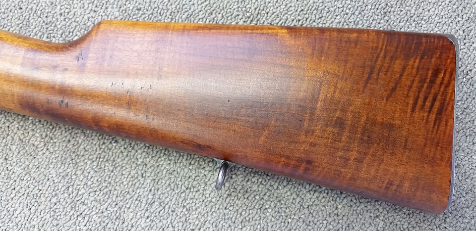

                              SVT-40
                              • 12894
                              Sweet! maple stocked rifles are a real rarity. I have a maple stocked m/96. I don't think I've ever seen a m/38 conversion with a maple stock other than yours.
                              The figure in the wood of your stock near the butt is pretty amazing.
                              I bet your m/38 sporter is a pretty accurate shooter. I also have a m/38 sporter it was originally a 1914 made CG rifle. It's really really accurate.
                              Based on the SN of your sporter it should be a 1900 made Mauser m/96 receiver. Also pretty rare as not many Mauser made m/96's were shortened to m/38 length.
                              Pic of the flame in the maple of my m/96 stock.
