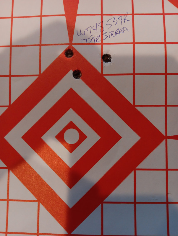

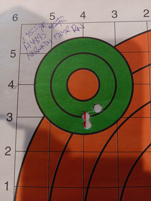

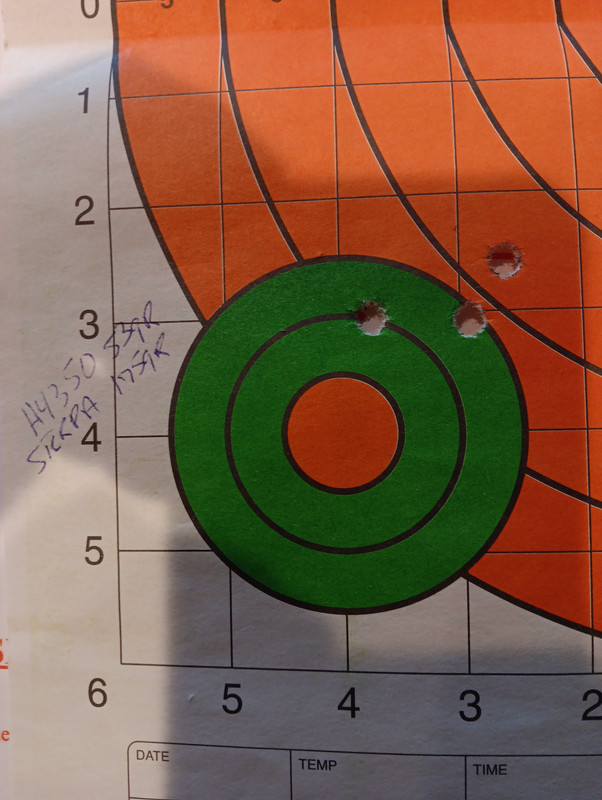

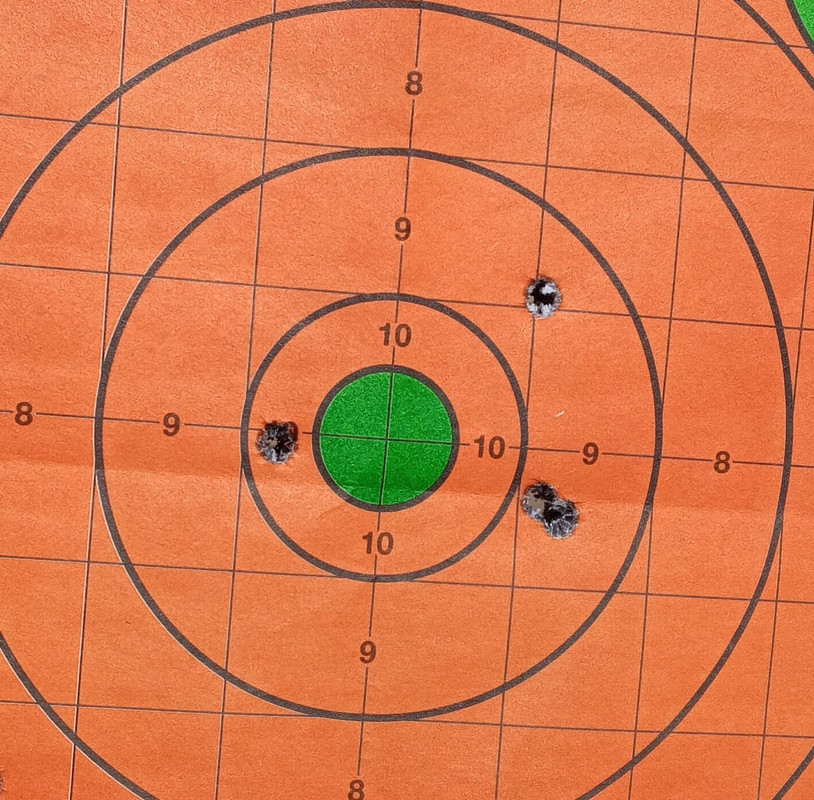

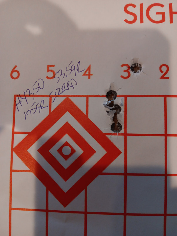

                              I can do more pics the next time out, but here's the preliminary range report for those interested. Keep in mind this rifle still has the crappy military two stage trigger, and is not bedded - although I did hog out the barrel channel to free-float the barrel. Bottom line is, it's shooter. Despite some worn looking lands, it will shoot into roughly 1" at 100 yards depending on the load/bullet.
                              I had two bullets on-hand (besides the pulled Romanian FMJ's) and a few powders to test with. The bullets are a 175gr Sierra PSP and a Hornady jacketed lead round nose. I used H4895, H4350, and W748 as my test powder. After shooting a group with the Romanian FMJ to warm up, I fired test groups from a benched rest at 100 yards. The Hornandy RN grouped the best with H4895, but POI was lower than the other pairings. I'll try it with other powders to see how it does.
                              The Sierra 175gr bullet shows a lot of promise, especially with the W748. It's already at pretty much 1MOA, so good enough for hunting.
                              Below are pictures of the results.
                              First, the Romanian FMJ, loaded into a commercial case using the pulled Romanian powder:
                              Then the test loads, using various powder with the two bullets I have on-hand:
