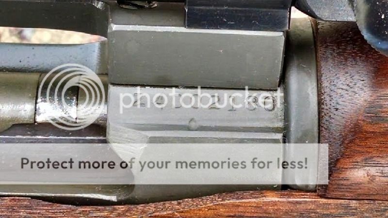

    Remington 03-A3 A4 Rifle guru needed
    I just won an auction on a Z marked A4
    The font on the Z is different than the others does anyone ha
    Ve pictures of a Z marked with a larger font w
    Ith a "foot" on the z ? There's a thread on the
    Milsurp forum but no picture to back it up

    Is this the same rifle that was posted to the 1903 page on FB? The one with the scant stock and the serif Z on the receiver serial? If so Ive never seen that style of stamping for the Z prefixes. From my understanding they were all stamped sans serif Z which is the same as the N stamp just turned sideways.
    Try cross-posting it to the CMP forums and the "1903 Springfield Restoration Group" on FB. They have alot of guys who may be able to figure it out.
    Sans Serif Z serial number stamp looks like this

            I would ask for clear detail pictures of the "weak" serial number and another of the cutoff feature on the receiver with the cutoff in the down position.

              Hey Ken, Heres the photo that was posted showing the serial number. I dont think that there are any photos of the cut off at this time, unless Op is already in possession.

                  Z looks not right. Shouldn't have serifs, I believe.
                  The cutoff features are all basically typical throughout the whole series of 1903's. If it is a reclaimed drill rifle you will see evidence in the cutoff area as the majority of them had the cutoff welded to the receiver, as well a the barrel tacked on. Some welds were done nicely, others were done with what looks like a scratch pass of 6011 with the machine set way too hot by a three day apprentice. Either the weld affected zone takes on a different color when refinished, and/or the machining of the receiver doesn't match the original profile.
                    See that's the part that everyone is so far agreeing on. That Z is wonky but the serial number is in the correct range for the Z prefix and it appears to be legitimate 1903a4 receiver with the stamp spacing it has. That Z though... Not sure if its a reclaimed drill rifle, but maybe the Z washed out and someone tried to restamp it?

                      Could be legit. ??
                      If the receiver is straight it is more likely a kit bashed "sniper" rifle, probably assembled right after Saving Private Ryan hit the screen.

                        The Bolt cycles slicker than Elephant snot.
                        I did see on one forum of a "Long Foot" in a larger size. But no picture to back it up
