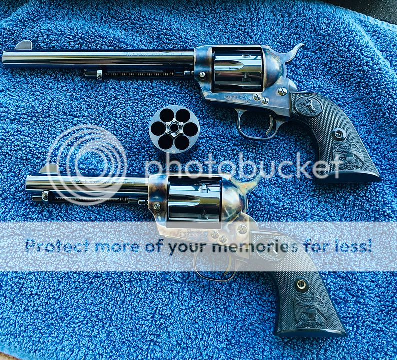

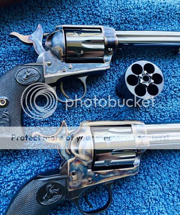

    These are two newer 3 rd Generation Colts which have a removable cylinder bushing. With this feature I’ve bought a Colt 45 ACP cylinder whereby I can fit separate bushings to the cylinder to allow use in more then one gun. I don’t reload so factory 45 ACP is significantly cheaper then 45 Colt. I’ve had hammers case hardened to resemble look of older Colts.

    Very nice!
    When swapping from gun to gun, you have checked the chamber to barrel timing / alignment too, I presume.

      Nice guns. When did Colts go back to original style cylinder bushings in the 3rd gen? Who did the case colors? Did you have just the hammers done, or the frames too? I had one done by Turnbull years ago, love the look.

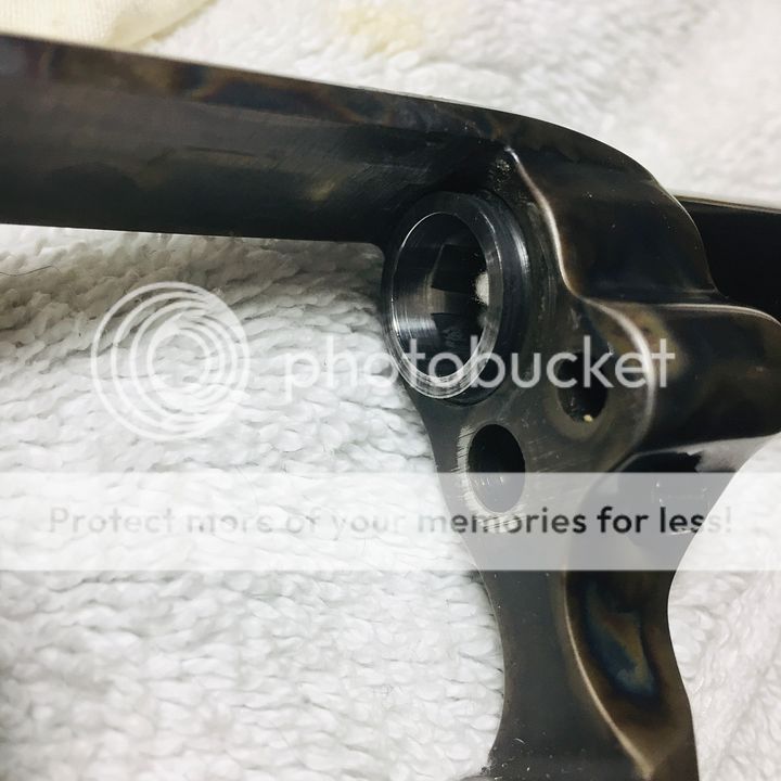

            A little education is in order here. I did not know this until I owned a few Colt SAA revolvers. If they are timed correctly,( hand wise and bolt drop wise) you will
            NOT leave a cylinder drag line no matter how many times you fire it or cycle it! You will eventually leave some marks in the notch area after time. A turn line on a Colt is a sign of abuse. You NEVER lower the hammer from the half cock postion by pulling the trigger and letting it down,you cock the hammer all the way back and then carefully lower it. Both guns have been fired a few times ,they have been cycled hundreds of times,you see what you see. Also,I do not dry fire these guns (even with snap caps). You never thumb cock the hammer half way and spin the cylinder,either.
              Colt went to removable bushings around 2004 at serial number S35000A.
              The hammers were done by a gunsmith from WY who specializes in SA work. I
              installed them myself. The frames are original Colt. Long barrel is from 2021
              bottom gun is 2011.

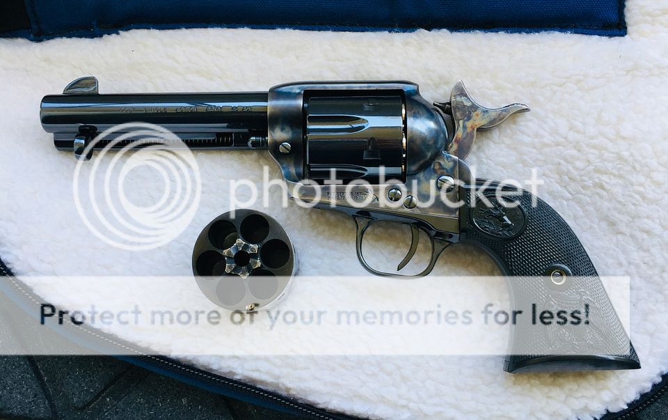

                  Those are great looking guns. Who did the hammers for you? These two of mine are are .44 Specials. Top one made in 1982, right when Colt was doing it's worse work putting these guns together. I lucked out as fitting is excellent, though case colors a little dark. Not vibrant like yours. Bottom .44 Special is 1992. A .44-40, actually but came only with the .44 Special cylinder. Very faint case colors, fantastic shooter. I hate their fixed bushings but have tried 2nd gen cylinders I have and they function in them. And tighter when I use the right bushings.

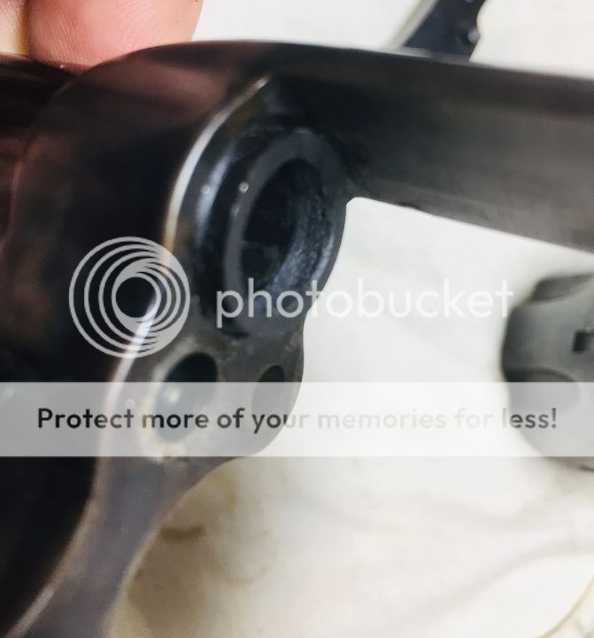

                        Pictured is a dual cylinder 45 I bought USED. It had not been fired in ACP but had taken hundreds of 45 Colt rounds. It was filthy. I fired a few hundred ACP
                        ro7nds and cycled it hundreds of times ,before selling it to a gun writer. See the condition after all this.
