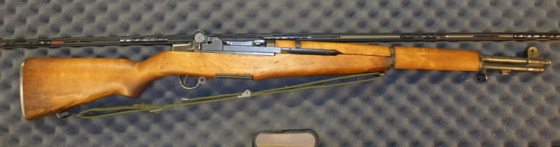

                    I got an IHC Garand from the DCM, way back when, that was in birch furniture:
