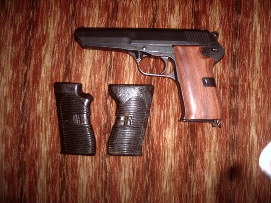

The CZ52 is fun, but not very practical. It's heavy, not very ergonomic, the grips are big and awkward, the sights are terrible, the trigger is poor unless you do mods that disable safety features, the ammo selection is limited, the firing pin breaks easily with dry-firing, and the firing pin block doesn't work when it's a little bit out of battery. Magazines are relatively expensive for such an inexpensive gun. Mine has a nasty trigger slap that makes my finger go numb, but not all of them do.
On the plus side, they're cheap, easy to disassemble and clean, you can improve the grips with a Handall slip-on. They're loud, with nice muzzle flash (depending on the ammo), milsurp ammo is cheap (but corrosive). Much of the milsurp ammo has hard primers, requires an occasional double-strike, and is prone to split necks and cases, but they're good for clearing exercises!

The trigger in standard form pretty well sucks, but I don't feel the improvment kit from Makarov.com makes it actually unsafe. It just substitues a firing pin return spring for the return plunger. Just don't go air-dropping it with a live round in the chamber. BTW, that kit kills two birds with one stone. It makes the trigger actually NICE and adds the benefit of a firing pin that shouldn't break.

Get one, and install the wood grips. As for the CZ's blowing up, I'm not sure if this was the case in all instances but if you fire Tokarev ammo that's made for SMGs out of your CZ-52, you'll end up with a nasty kaboom. The SMG loads are hotter than the pistol loads. Mine has never experienced corrosive ammo in my care; Winchester White Box ammo is readily available and not too expensive.
