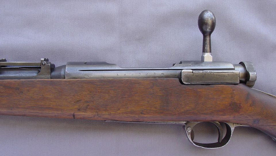

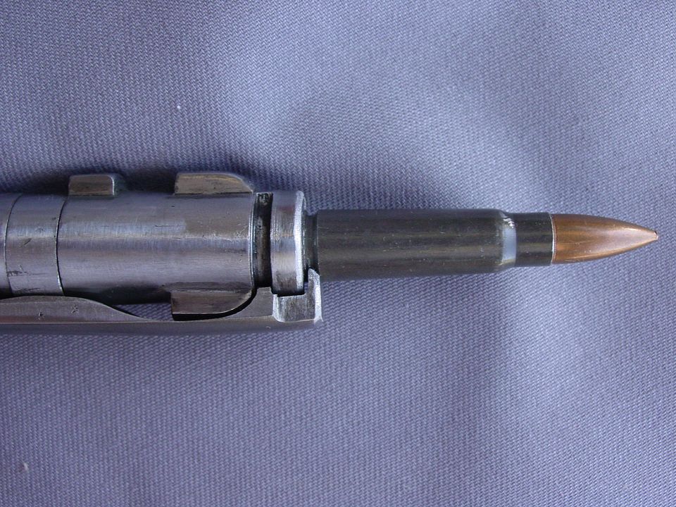

      The converted Jap 38 carbines can be fun, but they can also be a challenge. Here are a few pic's of mine including the bolt holding a cartridge.
      Does yours have a bayonet?
      Do you know where yours was converted. The rifle below was converted by the Chinese.

        A few more pic's.
        As you can see the Chinese didn't use a mag box filler. the feed ramp is milled into the bottom of the receiver. Under recoil the cartridges tend to be moved forward a bit, but the Mauser style extractor still seems to grab them when feeding.
        I don't think the Chinese were concerned with perfect reliability.
        Loading, extraction and ejection is problematic. My rifle has extremely tight head space.
            Does your bolt hold the round snugly and extract somewhat reliably?
            Have you worked on or replaced the extractor or bolt in any way?
            Here's what a dummy round looks like on my bolt
            I have no history on who did the conversion/when, wouldn't be surprised if it was domestic.
            But if I can get it running decently reliably as a single shot, without having to jam a rod down the barrel to extract every round, I'd call it a win.

              SVT-40
              • 12894
              My rifle is as it was when imported. It does look like the Chinese did some work to get better extractor engagement and some work to the bolt face. I have shot less than 50 rounds through this little carbine. It has more issues with the tight chamber than extraction. I have had the best luck using original Chinese ammo with copper washed steel cases.
