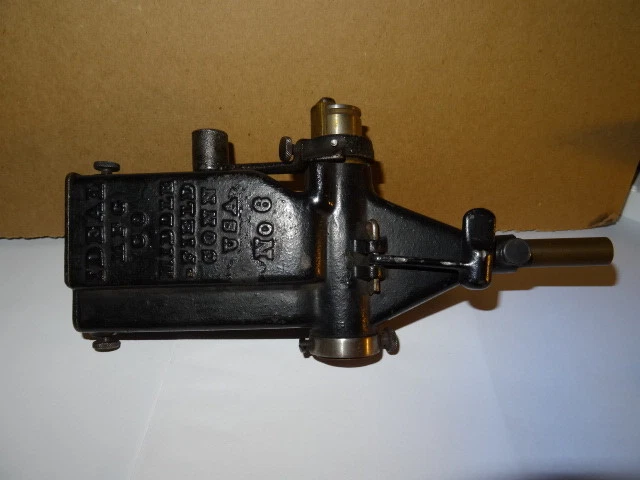

    In doing some relatives spring cleaning i came an item that is unknown to me...
    I think the patent date is 1882 or 1892
    Is this a black powder dispenser?

            In answer to your question: the possibility of a static electricity generated spark from the operation of the measure is generally considered to preclude its use with black powder.
            That may be wrong - they say you should not shoot damascus barreled shotguns too.

              Regular old Lyman powder measure for reloading metallic cartridges. Looks to still have its lid so that will help the value.
              The iron it's made out of will not create static. I'd be more worried about the newer ones with the plastic hoppers.
              I'd suspect the date is 1892 - since smokeless powder was invented in 1884.

                Looks like the moving parts are brass to minimize the chances of igniting powder.
                  Brass so wouldn't rust and stick in the rest of it. Steel on steel would require that it be kept oiled.
                    Ducky's Dad
                    • 737
                    Steel on steel can also spark. As can iron on iron or iron on steel.
