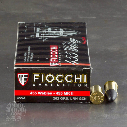

                    The modern Fiocchi ammo runs the 262gr at 650fps per their claims, but I think several reviewers say it is slower on their chrono at 550fps from a 6" barrel
                    Fiocchi 455 WEBLEY ammo for sale at AmmoToGo.com - Don't miss these 50 round packs of 262 Grain Lead Round Nose (LRN) ammunition in-stock now.
