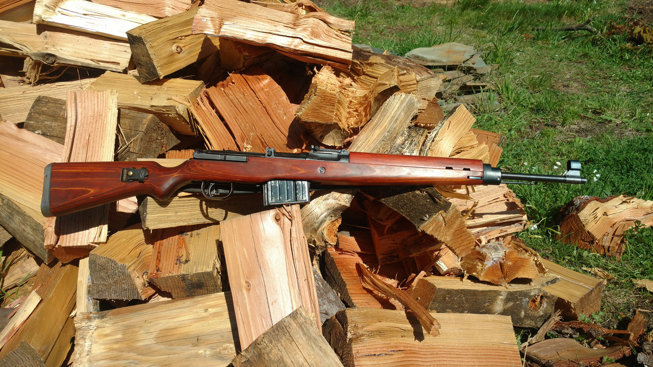

    I have the same issue. Offered $1,500 for this 43. Had a repro stock with ****ty Minwax and duplicating chatter. Smoothed it out and refinished.

        I figured the stock and ancillary bits were going to be the biggest pain to source, but it turned out easier to find them than I thought it would be. After I got it home I disassembled it and was very pleasantly surprised to find that internally it looks new and as I mentioned, the bore is perfect. I know it will never be original again, but for the money, I am happy with it.
        Edited to add: How did you get that shade of stain for the stock?

          One coat of Fiebings dark brown alcohol based leather dye and three coats of tung oil. Buffed with 00000 oil free steel wool between all coats. Finally rubbed down with Johnson Paste Wax.
          It is hard to find their alcohol dye in CA. I had to get mine from eBay. WEAR GLOVES! I find the dark brown (more coats the darker) matches military colors. Depending on country I will use tung oil, pine tar, BLO, cold pressed linseed, shellac, or urushi (Japanese stocks).
          I was able to get urushi lacquer in a small tube to restore a bubba'd Type 99. Then I touched part of it without a glove and got the same reaction as touching poison oak.
