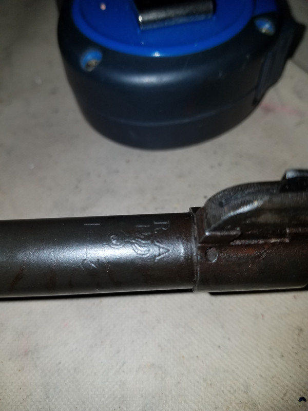

            Post Update with Pics!
            So I thought this string would benefit from some pics.
            About half the parts I can see were marked with "R"s. I need to tear it down, and clean off all the cosmoline.
            But it appears I have a mixmaster, that is in good shape, with a great bore.
            Not sure what I think about all the non Remington parts.
            I assume it got arsenal refinished and rebuilt at some point.
            Its gonna get shot, so I don't know it has to be perfect.
