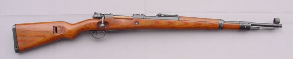

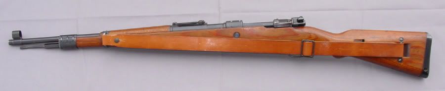

    Cool post WWII sporter. This is what your rifle looked like before it was sporterized!

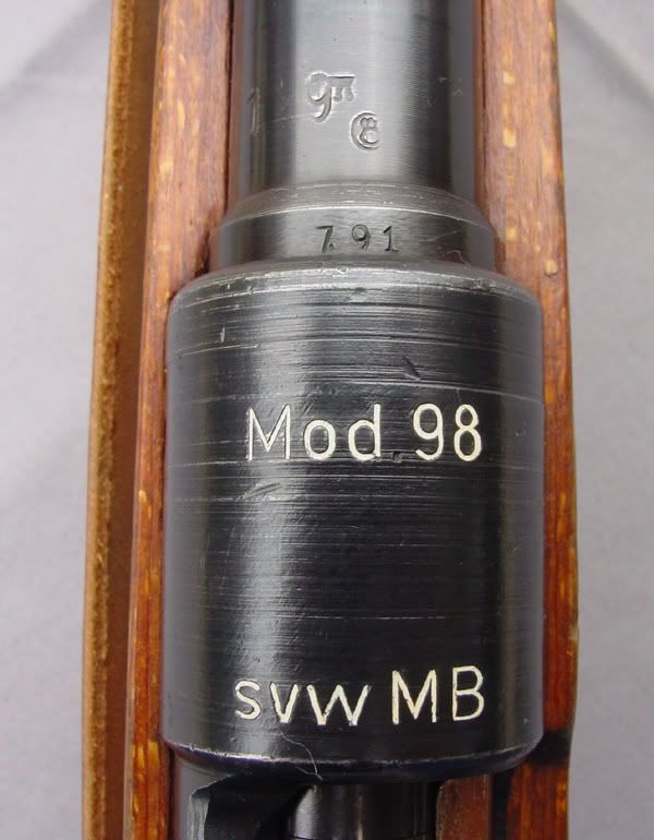

    The "star" in front of the serial number indicates post WWII manufacture under French supervision at Mauser Orbendorf.

      Per my Google research there appears to be a split of opinion on the "SVW MB" usage. Some say it was the last Oberndorf markings used by the Germans at the end of the war that carried over into the French supervised manufacturing, others say it was only used after the French were in charge. Either way this is only a point of curiosity as pertains to my sporter, but I can not tell if it has a star or not from the photo of the serial number area that was included on the auction page. The photo is not the greatest and it seems the receiver may have been polished up a bit before bluing. We will give it a closer look when the gun gets here.
