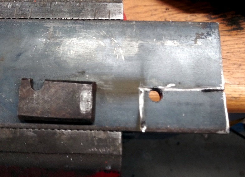

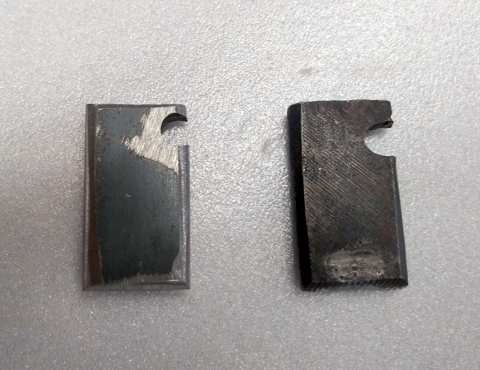

A cursory inspection revealed that the locking bar was very worn and loose in its slot, and that this was the reason for the wobbly lockup. I needed a new locking bar..... but where to find one for a low end 130-year-old Belgian double? eBay? Nope. GPC had on for $9 plus shipping, but who knows what condition it might be and even if it would actually fit my action. So - I rummaged around in my work space and came up with some left-over bar stock from a trailer hitch repair project. Turns out, it was the perfect thickness.
I traced an outline of the original on the scrap, and went to work. The drill press, some files, a belt/disc sander, and a Dremel were all put to use. The first one I buggered up, the second one was acceptable (but I thought I could do better), and the third one was the bullseye - it locked the action up tighter than a monkey's bung-hole. Some beveling, polishing, and final fitting and viola..... works like new, nice and tight, very smooth and solid.

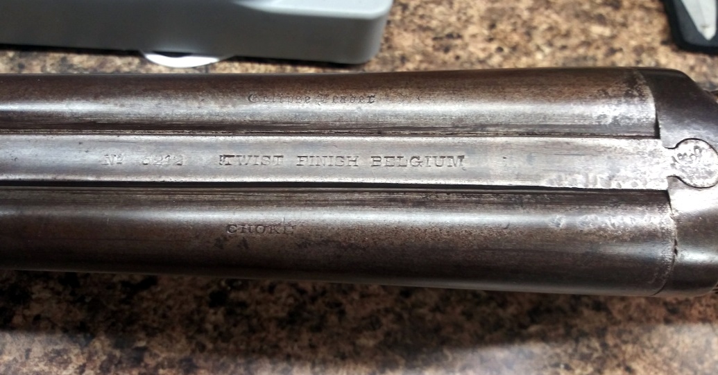

The gun is now all cleaned, repaired, and back together. Marked "Twist Finish Belgium" on the top rib, the best internet info says this is not a Damascus Twist barrel, but rather a "fluid steel" barrel made to look like Damascus in order to fool the eye of the fellows that were used to Damascus and wary of "newfangled" technology. One of the more interesting things I find is that, despite being an inexpensive shotgun, all the pieces are serial numbered - action, barrels, locks, trigger guard... even the furniture..... which, by the way, once had some fairly fancy hand-cut checkering.

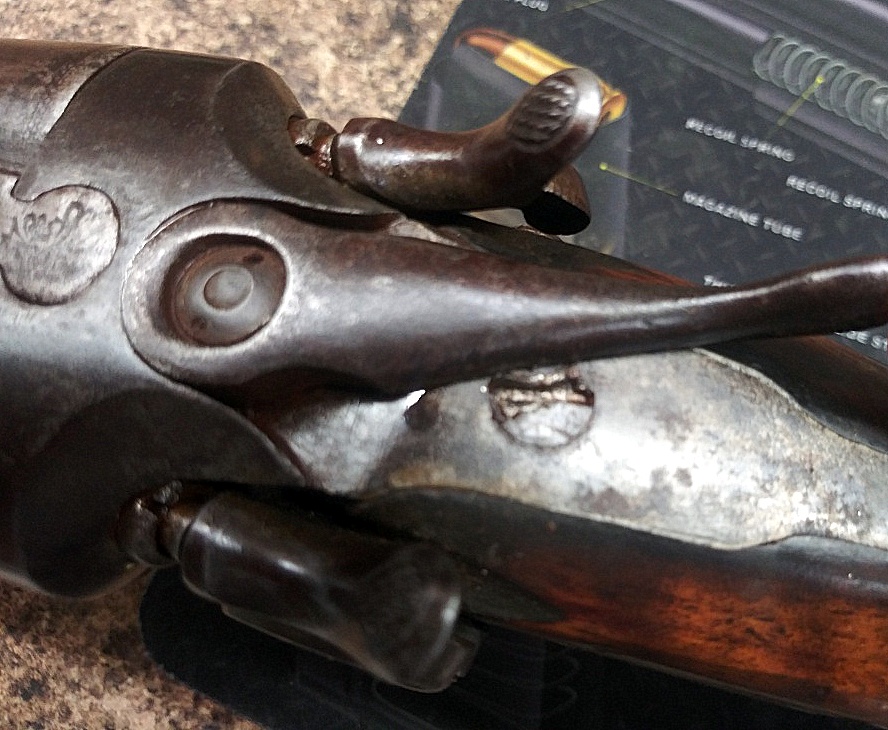

You can see where the barrels are tipped up slightly in the loose action:

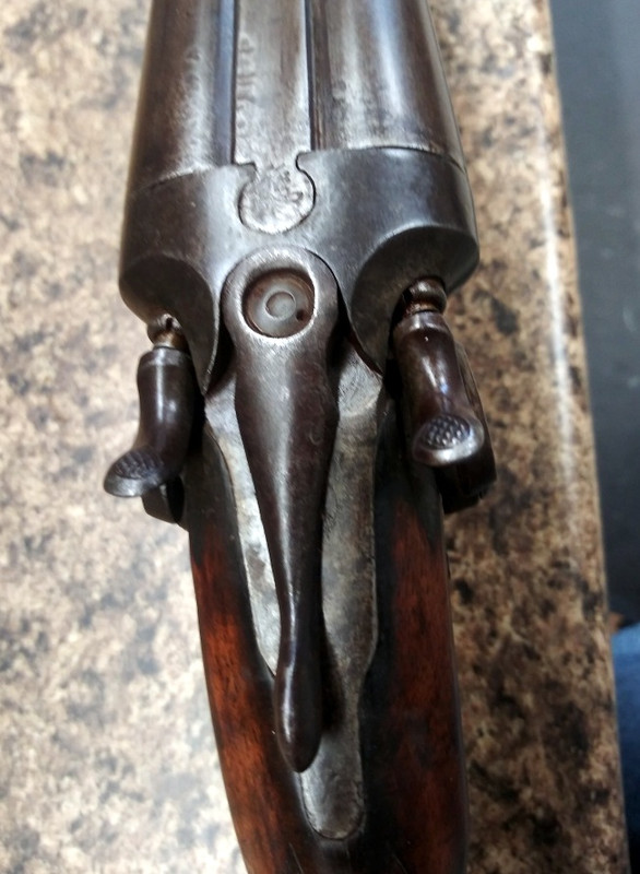

Buggered up action screw:
Original locking bar on top of bar stock:
New locking bar next to old one:
