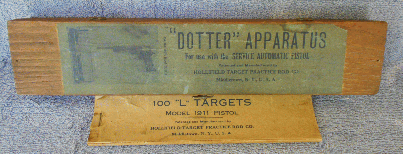

    Found 1911 “Dotter” Apparatus
    Found it going through an old box belonging to my late Grandfather. Not sure what it is or exactly what to do with it? Years ago I sold a ton of WWII-Korea era 1911 parts my Grandfather had procured during his time in service. Most all were sold on this forum.
    He served the Army and eventually retired Air Force in the 60s having served on their 1911 marksman team for a bit. I imagine this is from that kit.
    Two of the three rod apparatus have spring tension and appear to work. One of the rods lacks spring tension and appears to be missing the spike on the end of the rod.
    Any information would be greatly appreciated. Is there a market for this kit?

    Apparently it was used for target practice, though I'm not sure how it works. Google "dotter apparatus".

      Judging by the spring loaded rods, I’m guessing the firing pin strikes the back of the rod, and the spring loaded rod with the spike on its end come screaming out. That spike then punches a tiny hole in paper target held close to the muzzle.
      Pretty cool gun case piece for the 1911 collector. Auctions vary from estimate $200-500. One that sold for $190 seemed to only have one rod and was incomplete. Mine has all rods (although one of three is broken) and no paper targets. The good thing is mine appears to be much more complete with those three rods filling the box. Box is still rigid.

        Here is an item which is new to me. Have never seen nor heard of a Hollifield "Dotter" Apparatus. I know a lot of you more experienced collectors have seen this before. Thought I would post a few pictures for those of you who like me, enjoy seeing something new. These were used for indoor...

          As I mentioned, mine has three rods and no targets left. The box clearly fits three rods side-by-side perfectly.
          From my research there’s only 2220 made and all of them were purchased by the Army around 1912.
