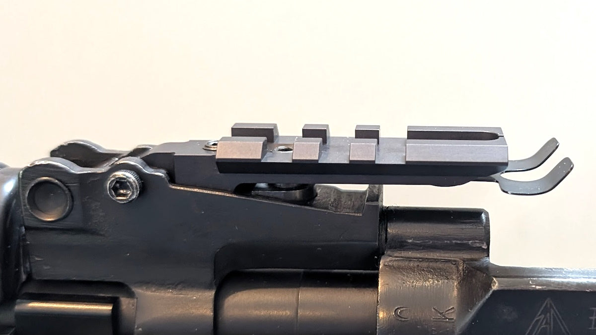

              What about this mount if I go for a compact red dot instead of a scope?
              [Firearms, optics and rings are for display only and NOT included] Compatible with all SKS variants including the Russian, Chinese, Romanian and Yugo SKS including the Yugo Model 59/66.  No drill, no tap, no permanent modification to your SKS rifles Allows easy disassembly and cleaning of the gas tube and dust cover -
                echo1
                • Apr 2010
                • 3927
                https://www.badacetactical.com/produ...-back-up-sight
                Of those type of mounts, it looks like that one has an advantage with the built in back up sight. But you've changed up from scope to Red Dot scout mount. At least it's reversible when you find out why others have said "Don't mess with it". PAX

                  AlienHobo
                  • Mar 2016
                  • 695
                  I have one of those with a small red dot sight. It works just fine. As my eyes get worse, it just gets harder to use the iron sights.
