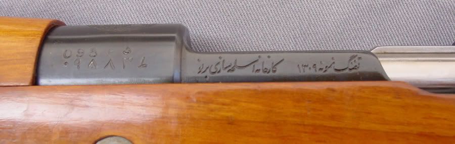

    Can anyone in detail provide information and ideally pictures on all the models of Persian Mauser? Details such as differences, which parts should be matching, rail markings, other part stampings, etc. I believe the models are, but I'm not 100% certain:
    Czech Made 98/29 1309 Long
    d) Persian Mauser M1309

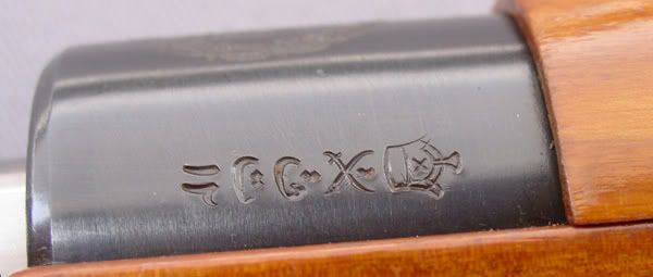

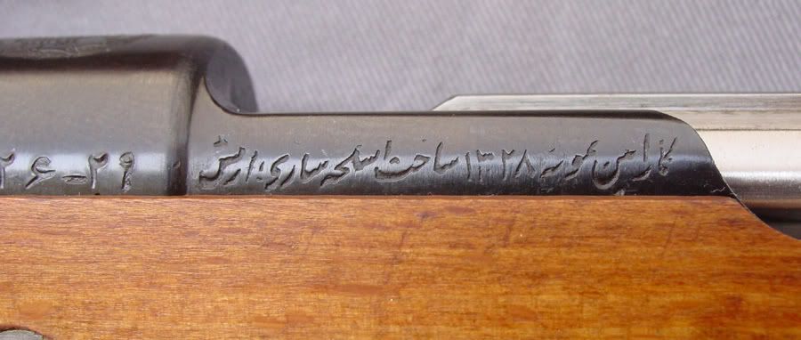

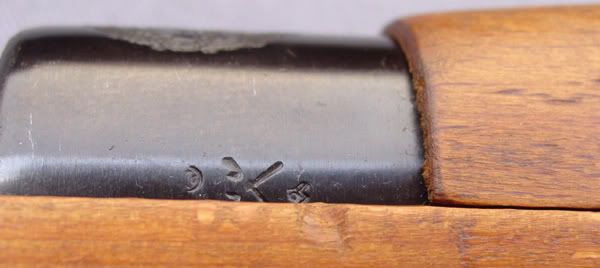

    1.) Complete Farsi serial no. - Receiver, left side
    2.) Complete Farsi serial no. - On top of bolt handle
    3.) Complete Farsi serial no. - Right side of butt stock
    4.) Complete Farsi serial no. - Bayonet, on pommel
    Persian 98/29 Model 1309 Long

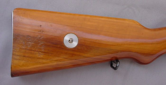

          Both of mine are all matching (receiver, bolt, stock) and only the 98/29 is import marked (Samco).
          As for my 98/29 stock, does any know what is written under the serial number? Looking for more history of this gun.
            Yes 98/29 only comes in the long variation.
            The number written under the Persian number denotes English Police use post War. I have to find the exact info. Mine has it as well.
