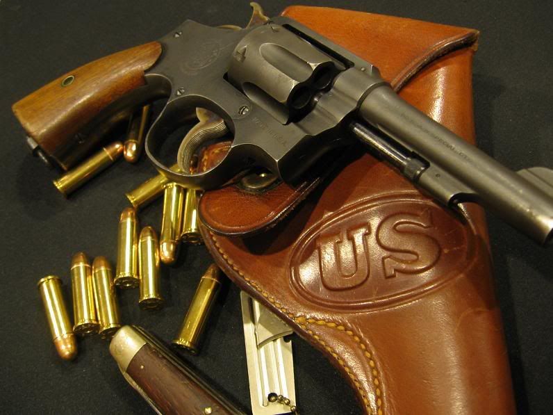

          does it have a V stamp? No V mark and it's either pre-war or post-war
          Does it have US PROPERTY marks? US PROPERTY marks generally mean lend-lease
          Note the barrel length, most .38S&W variations came in 5in
          Also, did you know you can write a letter to S&W and request a history on your revolver? it's well worth the $25 if it's from family
          Here's mine, i haven't seen it in a while because it floated under my desk
