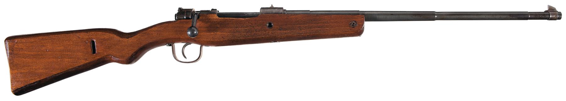

    I was visiting a friend in Parker AZ and his neighbor new i was into C&R and wanted some info on a old German rifle his uncle brought home as a Battle field pic up. At first glance [ limited K 98 knowledge ] i thought it was a sporter K 98. but what it is is a 1945 poorly made K 98 with many deleted parts.
    The receiver on top has BNZ45 and on the side it has a intact eagle and ser # 7059.
    The stock is very poorly made and un finished. Never had a but plate. No magazine floor plate , just solid wood. the trigger guard is a simple bent metal strip with wood screws on front and rear. It has no hand guard and the forend of the stock is shortened. the front sling swivel is a bent metal rod formed into a sling swivel and inserted into a hole in the stock and bent over like a cotter pin. the rear of the stock just has a slit big enough for a sling to go threw it. The front sight is small and no provision for a sight protector. the rear sight is a simple fixed sight with no elevation adj. The last six or eight inches of the barrel is turned down to save metal i guess. I had no way to take pictures. I told him i would try to get him more info on it. I did not want him to think i was trying to score a gun from him. He is very wealthy so he would not be interested in selling it. Nobody in his famely wants it after he is gone. A guy on gunboards said it is a very desirable late war K 98.

      found pics on the internet, it is a 100% unmolested VK98. I guess they are very rare and sell for a lot of money. I hope my friend can get it from his neighbor. they have been close friends for a long time .

        It sounds like you are describing the VK98. The Volk's K98. It was a last ditch crudely made rifle made from whatever bits and pieces could be rounded up at the time.
        They tend to be bnz 45 receivers, with all manner of other parts used. Some even used turned down maching gun barrels turned down to fit a k98 receiver.
        Here are a couple of pics and some info.
        Late WWII German "VK98" Bolt Action Rifle - Rock Island Auction Company
        Scarce Late WWII Nazi "Volksgewehr" Last Ditch VK-98 Steyr RifleThis rifle was manufactured and issued in the last months of the war in 1945. Due to the continued allied bombing of the German arms factories the Steyr plant developed a late war, last ditch 98K type rifle that was termed the VK-98 or Volksgewehr or people's rifle. They were intended to use the most readily available material left in the factories to produce a suitable service rifle to equip the German people in the last days of the war. These "Volksgewehr" or people's rifle used late production or rejected receivers, with a standard 98K barrel, without the normal military sights and in their place. They used a simple machining rear sight made of bar stock, dovetailed into the receiver ring with a simple front sight blade welded on to the top of the barrel with the muzzle free bored to eliminate any additional machining operations. The stock was a one piece hardwood board stock, that was fitted with a stamped and bent sheet metal trigger guard. The bolts were usually late production without the guide rib that were in many cases roughly finished. The top of the receiver is marked with the small "bnz 45" markings only with no other markings on the rifle. In this case the serial number only is on the side of the receiver. There is no internal magazine as this is a single shot version only. These rifles are very rare in collections today as most returning GI's never considered them a suitable "war trophy" and never brought them back.

          I have a BNZ45 that is a mishmash of late war stamped parts. Other than the crude phosphate finish it shoots and cycles like butter.

                It is the same as the bottom example THANKS

                      Ever since that book - Desperate Measures by Darrin Weaver - came out, more people have been looking for these weapons. http://www.amazon.com/Desperate-Meas.../dp/0889353727 There have been a lot of weapons called fakes if they vary from the pics accepted as standard representations of these rifles. Supposedly it is not hard to fake these stocks.

                          this rifle was brought home after WW 2 by the person that got it in combat. I was told he brought home 5 rifles. This is the only one that was kept in the famely after his death. I am as sure as i can be that this is a authentic VK98 .
                          It has been owned by two famely members since 1945 and neither one is into guns.It would be very hard to do all the things necessary to fake this rifle. The one in the picture is much nicer looking than the one i saw.
