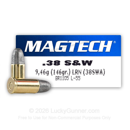

        25.00 a box reloadable, and it's an easy cartridge to reload, even for beginners. https://www.libertytreecollectors.co...&idcategory=69

          .38 S&W is still made and not outrageously expensive. Availability might be an issue in the current market, i.e. being sold out.

            three different brands, in stock...http://www.ammunitiontogo.com/index....tol-ammo-38-sw

                    Yeah ultimately. What i've done is buy 5-6 boxes of PPU which runs about 19 dollars a box. I've almost shot it all and now have the brass for reloading.
