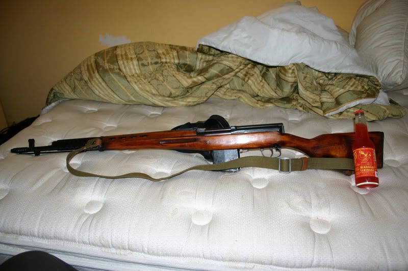

I have some Czech silver tip (metal case), and I think Yugo brass cased stuff I shoot in the SVT40 (you can see both in the picture below). Both work fine, but I think the metal case works a little better.
Here's my SVT40:
