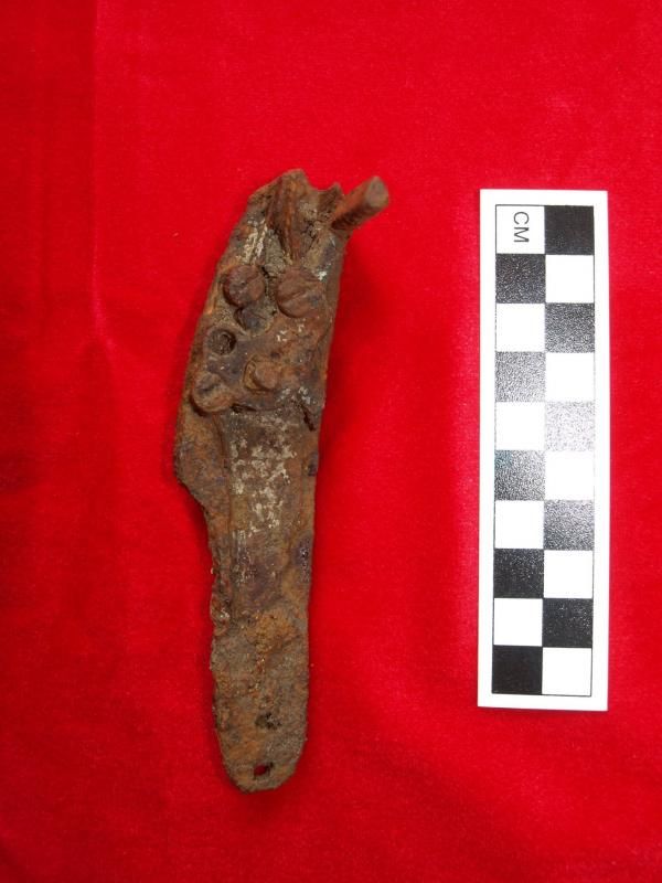

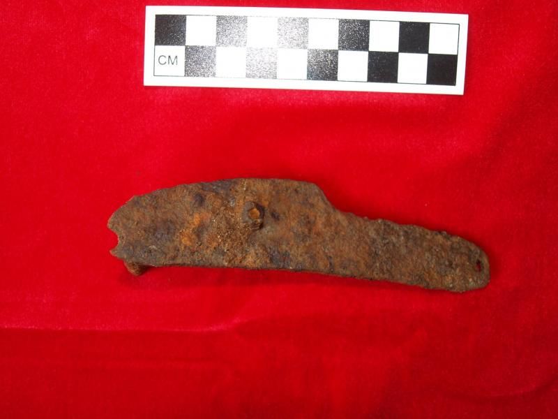

    I have a friend who is an archaeologist and she is wondering if something she found is part of a gun. Here is the info she gave me.
    "So, I excavated this in Veracruz, Mexico. I dated it to the 1800s based on the other diagnostic artifacts (namely ceramics) that I found along with it."
    "Perhaps one reason my mind went to gun was because there are always historic gun fragments being found in the town from where it was excavated- It was a hot bed for the Mexican Revolution. My neighbors there showed me something similar and other folks have shown me rusty rifles, too."
    Any info would be greatly appreciated

    Woah. Very cool. Hopefully someone here can shed some light on this piece.
    To my completely untrained, psychology-major eye, it looks like the sideplate of some kind of flintlock mechanism.

      Yup...side plate...
        IrishJoe3
        • 3796
        Muzzle loader lockplate, my guess percussion. Shape and internals look VERY similiar to US Springfield or Enfield.
        Google 1861 Springfield Lockplate 1853 Enfield lockplate

              Here is a link, if they are unfamiliar with firearms, so they can visualize what part it probably will be.
              In this picture, labeled as simply "the plate".

                      Veracruz? Could be from a Mexican, American or French rifle left over from one of the many invasions of the city during the mid-1800s.

                            Hard to tell for sure but it appears to be a 1853 musket lock.

                              If she is able to gently remove the rust from the inside center of the lock plate, there is sometimes a proof house mark - this could help determine date and nationality - (see the pic of the replica, with the crown proof.)
