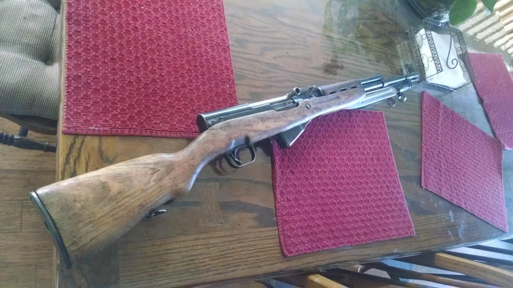

    I have a Russian SKS that I want to refinish to look more like what it did originally. When I stripped the cosmoline after I brought it home, there was basically no wood finish, which I found strange. I stripped the remaining finish off of it and applied a coat of Boiled Linseed Oil. I like how it turned out, but I'm not completely satisfied.
    What I want to do is finish this to have more of a "Russian Red" look. I've been told Rit dye is the way to go, but I figured I'd ask around here anyways to see if anyone has had success any other ways.
    I also want to preserve or re-stamp the markings on the wood. The markings are very faint and almost nonexistent, so I want to deepen those to make them more clearly visible.
    Any help would be appreciated, thanks in advance!

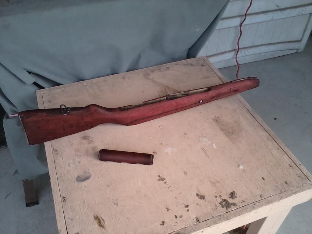

                        So i managed to strip it down almost fully so far. It needs some more work, but it's getting there. I'm in no rush so I'm taking my time to make sure it looks nice this time

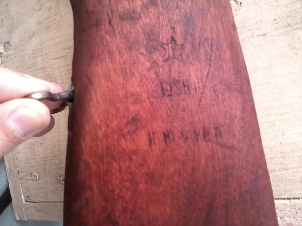

                            I've used Citristrip and Oven Cleaner to strip it down. As of now the RIT is on and looks really good! I even managed to save the markings, somewhat. I'm just waiting on it to dry.
