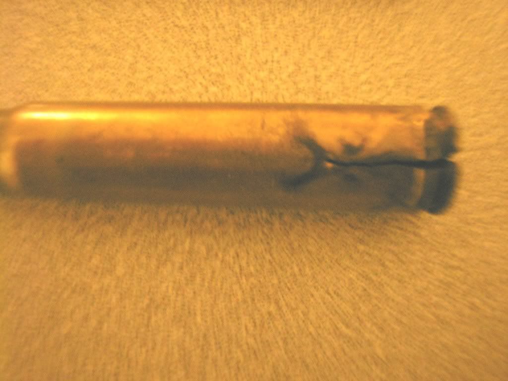

              The only case failure that is a real problem is a base failure like this:
              That is an action wrecker. The rest such as a case separation, neck split, vertical crack, as long as it doesn't go through the base are annoying and surprising but not catastrophic. The older action designs were so concerned about gas control because of the poor state of case manufacturing when base failures weren't all that rare. Base failures was what was taking low number 03s apart to the greater extent. These days if modern cases are used, base failures are non existent. I'm sure you are aware of all of this, this is intended for the shooters tempted to use suspect Yugoslav and Turk ball in their 88/05/35 Turk rifles.
                  Now this is interesting. How well do modern designs handle escaping gas in case of case failure?
                        Very well. It usually goes through the magazine well.
