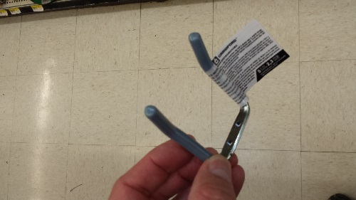

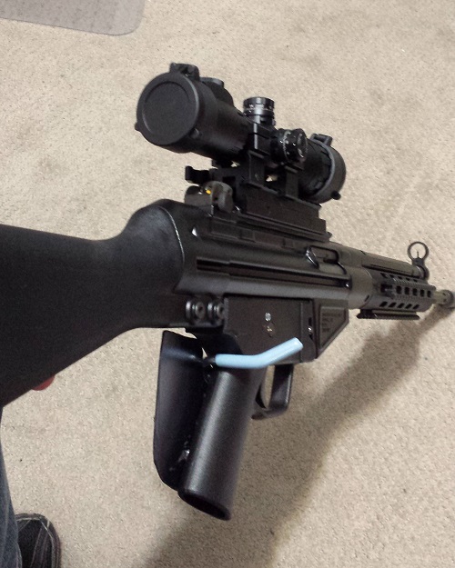

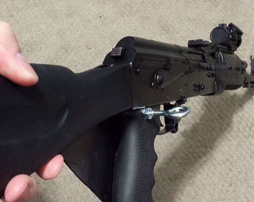

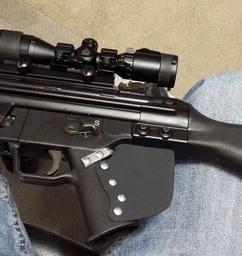

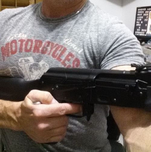

    While I applaud your ingenuity I can't get over the hardware store look and perforation of the wraps and pistol grips with galvanized hooks and stuff.
    Now if we were talking post apocalyptic times and you had to go
    Star Wars Edition...that's a different story...but in those times pistol grips would be unfettered.
    At the very least your Ace Hardware Mods deserve the black rattle can look
    Star Wars edition? No.... Mad Max edition... :-)
    On the black rattle can look, I agree. It's ugly. I thought about dipping the eye bolt into those rubber coating dips that are used for coating tool handles. I may still do that. If someone wanted to make nice professionally manufactured ones, there may be a market there - Maybe a nice black anodized post with a skull head at the end....
    Thanks for the feedback.

    New Idea for Better Featureless Grip
    CalGun Folks,
    My first posting...

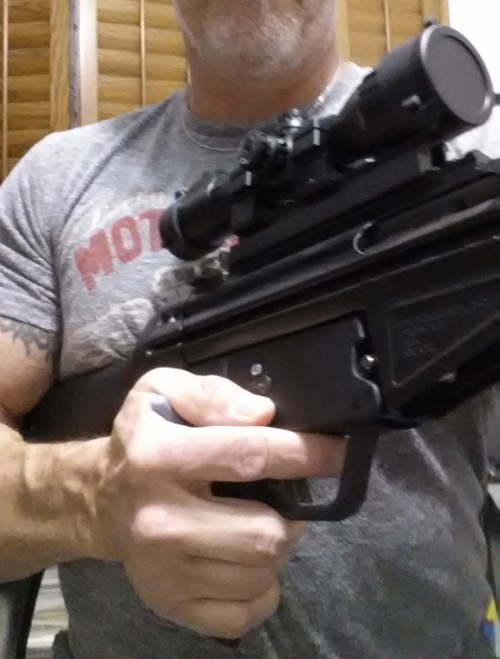

    I modified one of my AR15s and an AR10 to be featureless, but, I added something new that really helps the grip. Unfortunately, I have those two guns stashed away in a hiding spot so I can't photograph them easily. However, I did the same modification to an AK74 and a PTR91, which I have photographed. These will be fine for you all to understand what I did to my ARs.

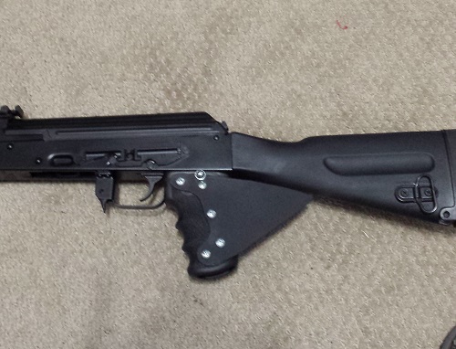

    On the AK74 example, after adding a Kydex panel on side to block the thumb wrap around grip (I did my own Kydex panel), I drilled a hole through the handle and added an eye bolt that extends out the right side (same side as my thumb). I wrap my thumb over the top of the eye bolt for the added grip - see photos. I tell you it feels pretty damn good. This way, the total cost of modifications, including the Kydex panel was about $3 per gun. I have done 6 guns thus far.
    For the PTR91, I took a slightly different approach. I used a common hanging hook (see photo below), cut off one leg of the hook, and attached that around the backside of the handle. The hook version is nice because it is rubber coated for an even better grip an the distance to the trigger is a better, longer distance and feels better. With my AR15, I have shot sub-MOA at 200 yards with this grip. Feels great.
    I know the modifications where I drilled through the handle is heresy for some purists, but, it is super cheap and relatively easy. And, if the Supreme Court dies it's job and eventually overturns these silly laws against "evil features," I can easily take these off or buy new grips.
    AK74 showing eye bolt
    AK74 showing Kydex Panel Side
    AK74 showing hand grip over eye bolt
    Common Hook (from Ace Hardware) for PTR91 grip
    PTR91 showing hook out of right side
    PTR91 showing Kydex Panel Side
    PTR91 showing hand grip over hook extension
    Enjoy. I hope other find this helpful.
    Ken in SoCal

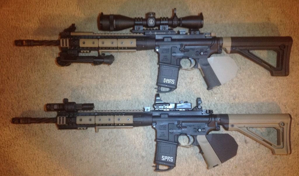

    His n Her
    LWRC M6 SPR MOD 0
    Midwest Industries 2 chamber brake
    Exile Machine back fin (one I painted FDE w/Brownells Aluma-Hyde)
    Magpul MOE fixed stock
    For patches o and jason
