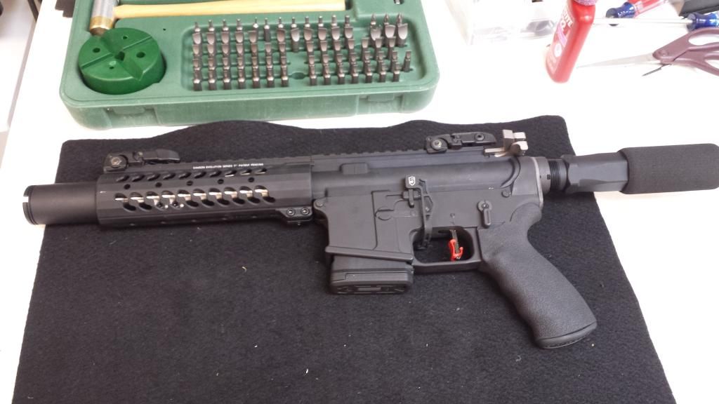

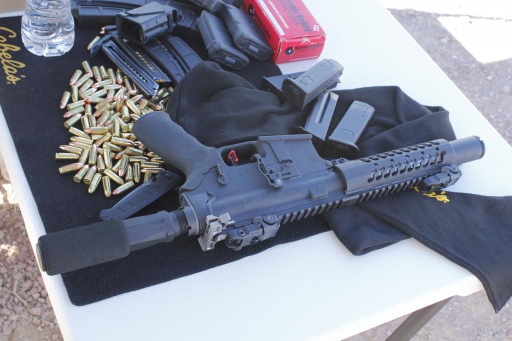

          pluke the 2
          • May 2012
          • 1926
          Minearen't touching
            pluke the 2
            • May 2012
            • 1926
              pluke the 2
              • May 2012
              • 1926
                pluke the 2
                • May 2012
                • 1926
                I just made sure that they are tight. Remember is aluminum so it doesn't bend much. Make sure you use loctite. And in not sure the way my screws are going is the correct way

                      pluke the 2
                      • May 2012
                      • 1926
                      no issues. ive got 500 rounds through her and she does recoil more than your average ar15
                      time will tell though. ive only taken it out once (one long weekend trip).
