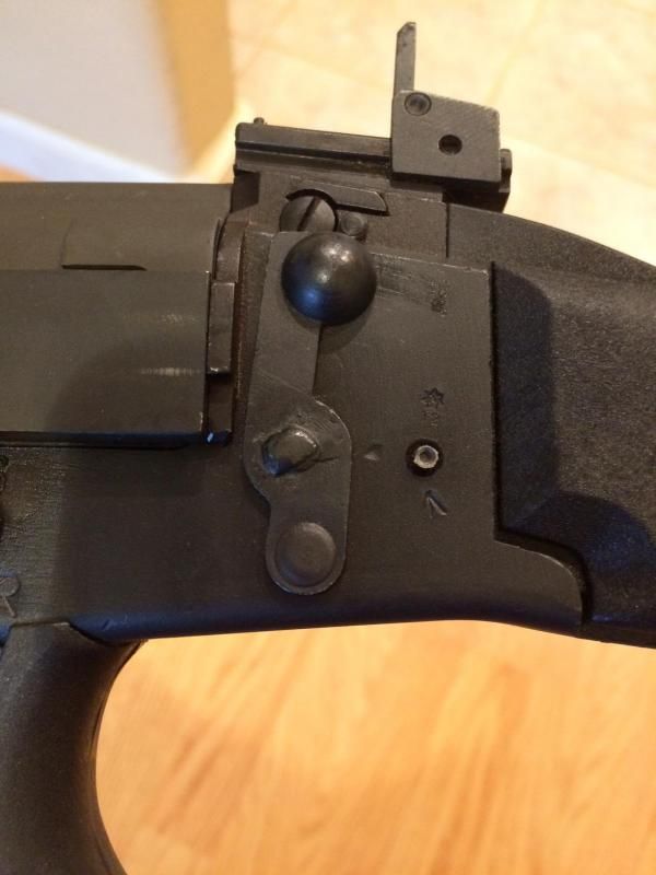

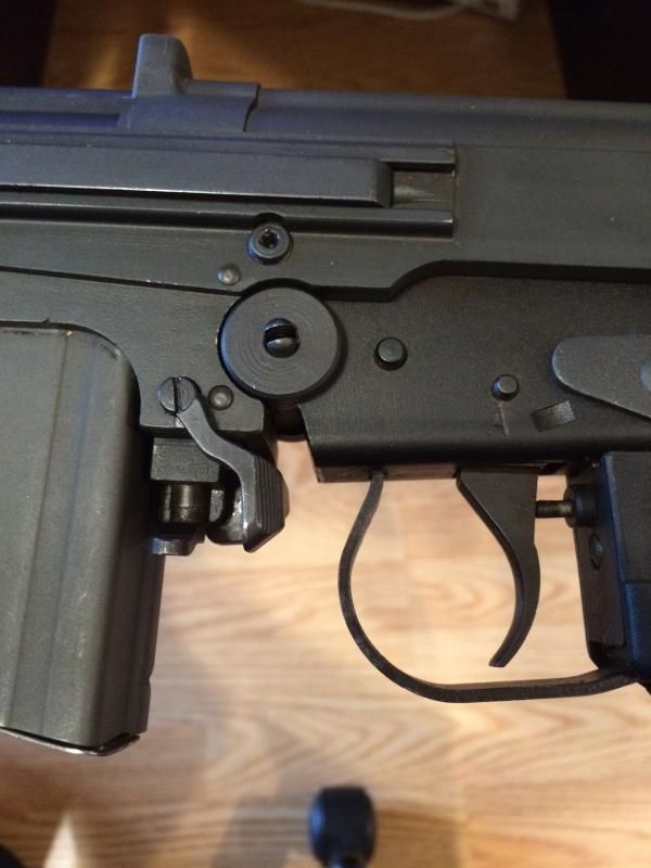

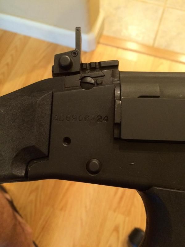

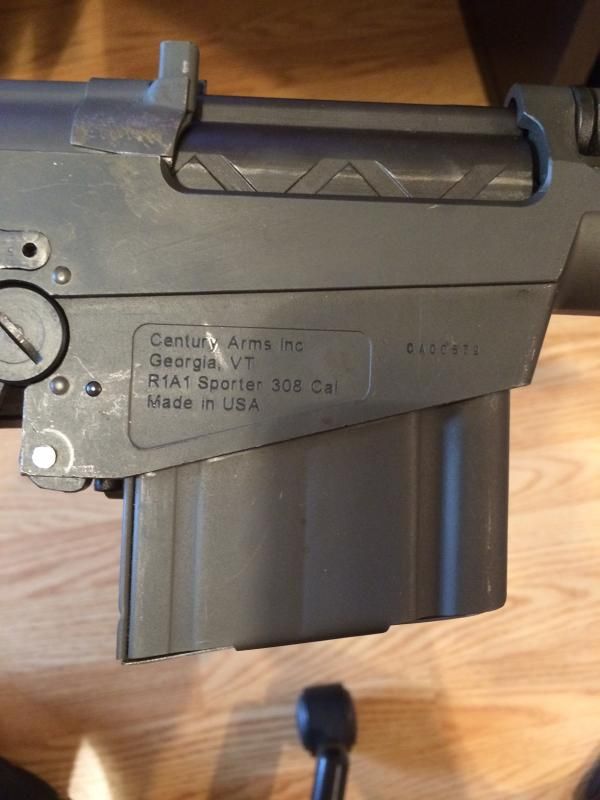

        Besides the Century Arms info on the magazine well, these are the only other markings on the rifle.

          The "AD" mark on the upper right rear of the lower indicates parts, save upper receiver, are Australian.
          Can you post 2 more pics...1 showing the marking detail on the right side of the upper, and a second showing the left side of the gun in the trigger/bolt hold-open/pivot pin area??
          The FAL Files may take a week or 2 to get your login done.
          eta...does the rifle use metric or British mags??

              For FAL's...Brit/British = Inch = Aussie.
              The receiver was made by Hesse, from what I can tell.
              Parts kit is Inch/Aussie based on pn on lower with "AD" marking. Mag release is definitely Inch. I hate to be a PITA, but I can't tell about the muzzle device as it's not in the picture.
              Google "century arms r1a1" for more info.
              Nice rifle.
              hth

                  CAI R1A1 receivers are simply metric pattern, with the magwell modified to take inch magazines. Metric mags are supposed to fit, though with some reported slop. I've never tried one as all my FAL's are metric. Notice the mis-match between the rear of the upper and the lower...clearly a metric receiver on an inch lower.

                      1-aside from your muzzlebrake your rifle is all inch pattern -Aussie,Brit, Canadian,etc
                      2- yes adjust the gas system for most failure to eject and short stroking issues..
                      3- your stripper clip top cover is fairly valuable so do not toss it,sell on the fal files if you decide to get rid of it.
                      4-IMPORTANT- you MAY have a full on Inch cut receiver which means you need Inch mags or there are a couple ways to help with the mag wobble.. First thing you need to do is get that mag out and look at the mag lug cut on the inside front of the receiver.. Look for the following to determine which mag style you need...
                      1- IF the machined cut in the receiver looks like a square cut,large rectangular cut=Inch magazine
                      2-If the cut looks like a half moon circular cut=Metric
                      **the lugs on the front of the mags are different and ecxess wobble CAN lead to chambering issues in feeding.. usually the front of the metric mag will droop down and mess up the angle. There are a couple fixes,work arounds... Inch mags are more expensive/less common but out there...
                      ***I would look into getting or making a grip wrap,looks stupid,shooting not to bad once used to it.. best thing is you can use any 20 rd mags you have squirreled away from when you lived out of state ,alaska?

                              Is that an Israeli bolt carrier, or are there others with the sand cuts?
