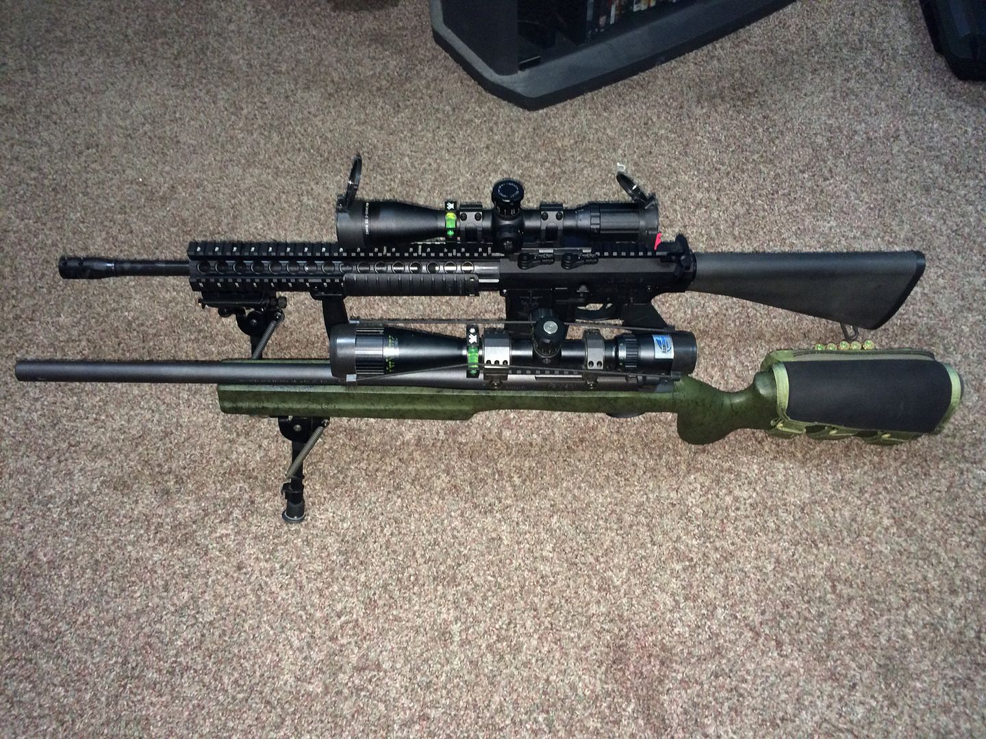

            18.
            I was set on 20" before I began my build, but realized the FPS gained with most factory ammo and fast burning powders the FPS gain was only around 60 FPS at the muzzle for the extra 2". Where you lose about 120 going from 18 to 16" so a total of about 200 +/- from 20 to 16..
            The 18 was the best of both worlds IMO. Decent FPS, with slight mobility. That said here is my 20" 700 and my 18" LR308.. Same exact OAL.
            I think 18 looks cleaner asthetics wise, my buddies 16 is awesome looking, but again I couldn't justify the major loss of FPS going to 16". He also built his for short work where mine was more a LR >1k yard type build.
            Also my barrel is a Mega, performance is good. As promised via mega. But some guys have sent a few barrels back due to some slight spec issues. I personally think my barrel may be slightly out of spec as well if you saw my JD rant thread. I think the barrel was the cause, even tho JD blamed he BCG and "fixed" it replacing the BCG. My suspicion is mega QC issues. So tho it's performed, and works and looks great. I have to bite my tongue on reccomending it due to my suspicions.
