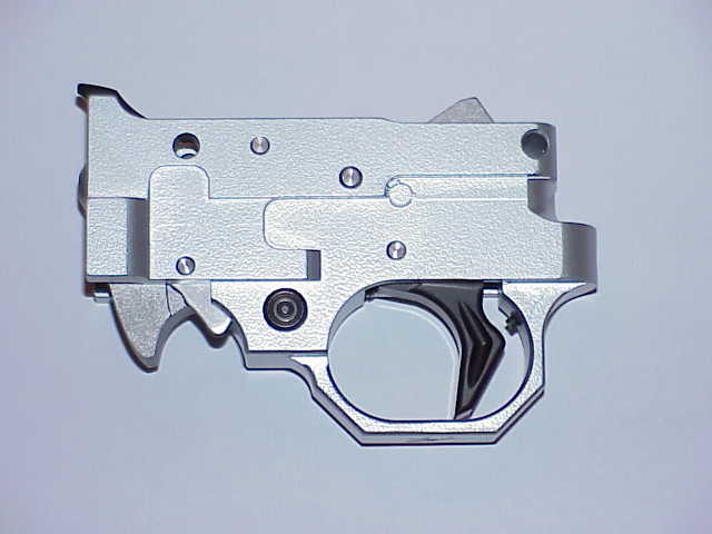

    The parts critical to accuracy are the barrel and the trigger. Keep the trigger guard. GM and Volquartsen make good barrels.
    Get a Power custom competition trigger kit and replace your stock trigger group parts.

        So the GM barrel, the Volq TG2000, and a used 10/22 receiver will work together. How bout a buffer? Is that part of the receiver or is that an extra parts kit? Or is something like the Volquartsen TG2000 have those parts? It seems the tg2000 is just the trigger assembly..and i'm sold on it because i hear it's the best way to get the rest of the gun to fire accurately compared to the stock trigger set. I haven't looked at a hornet trigger assembly, but I hear they're less expensive.

          In my opinion, the most cost effective way is to get a complete used 10/22 and replace trigger group parts with the Power custom kit. I am very happy with mine. Trigger pull is very light and crisp. I haven't measured it but I like it. The buffer goes in the back of the receiver. The used 10/22 will come with one. You can replace it with a plastic one that is supposed to reduce receiver stress, but that is not a necessity. Volquartsen parts are good, but they cost a ton. There are options. But yes, to answer your question, those parts will work together.

            As far as the trigger, either just get the Volquartsen hammer or the Kidd trigger (http://www.coolguyguns.com/Jan05Ruger1022products2.htm).

              Buy used 10/22
              - vq extractor
              - auto bolt release
              - bull bbl
              - bull bbl stock
              - vq trigger set

                      As for the trigger group, no need in buying a Volq or PC group w/housing. You can easily replace all the internals you want with either manufacturer's parts for a lot cheaper. Their trigger housing is no better than Ruger's.

                          But then I'll be without a trigger set, so I'd have to pick up standard trigger assembly parts...or pick up..
                          TRIGGER: This Volq trigger assembly
