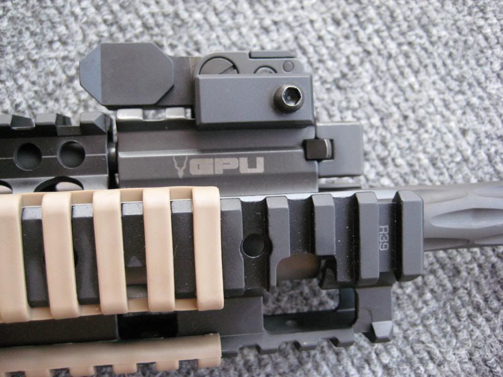

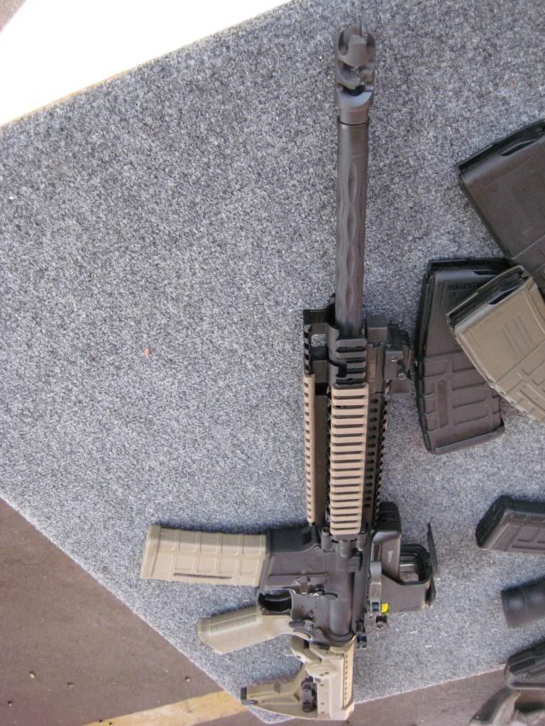

                        Not with the current design from PWS.
                        The Gas Piston Gas Block we use (PWS System) is already rail height.
                        The Gas Block and Gas Piston Tube design will not allow it to be mounted under a normal height rail, and we do not want to use that big bulky POF/Predator Rail.
                        We are using the DD Lite Rails (9.5 FSP for Carbines and 12.0 FSPM for Mid-Lengths) so the Gas Block sits inside the Front Sight Post cut outs and gives extra rail length on the sides and bottom.
                        This is how the gas block mounts in our uppers using the DD Lite Rail (example given is the Combat Carbine model using the DD Lite 9.5 FSP Rail)
                        Carbine with DD Lite 9.5 FSP

                          OP: Keep in mind the traditional handguards do exactly the same thing as the current design of rails - put the flex on the delta ring/barrel nut. There is a small amount of pressure on the forward attachment/barrel, but it's a fraction of the barrel nut.
                          If the current free-float rail design were really a big issue you'd hear about it across the board. Many tens of thousands of those rails are in current use.
                          In some ways, the sight on the barrel (gas block) is a better design, as any small amount of flex on the rail isn't transitioned to the sight. It's making the best of the design, IMHO - something that PWS and others do right. I don't see any reason, though, that PWS couldn't cut down their gas block in the future to be lo-pro. The DD FSP rails are very nice, and a good way to implement it.
