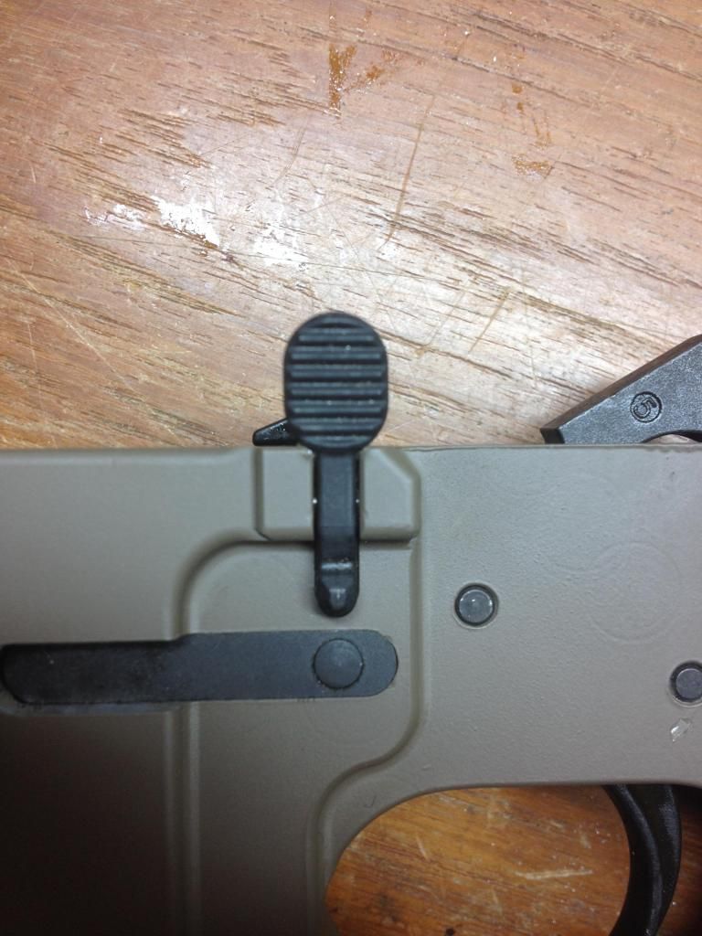

    Problem 3: The biggest issue. The bolt catch doesnt move at all. as in once i pinned it into the lower, it is pinned so tightly against the lower that it is jammed in place. basically it would not function at all once the final round is shot. Again i think the hole for the roll pin was not drilled in the proper location.

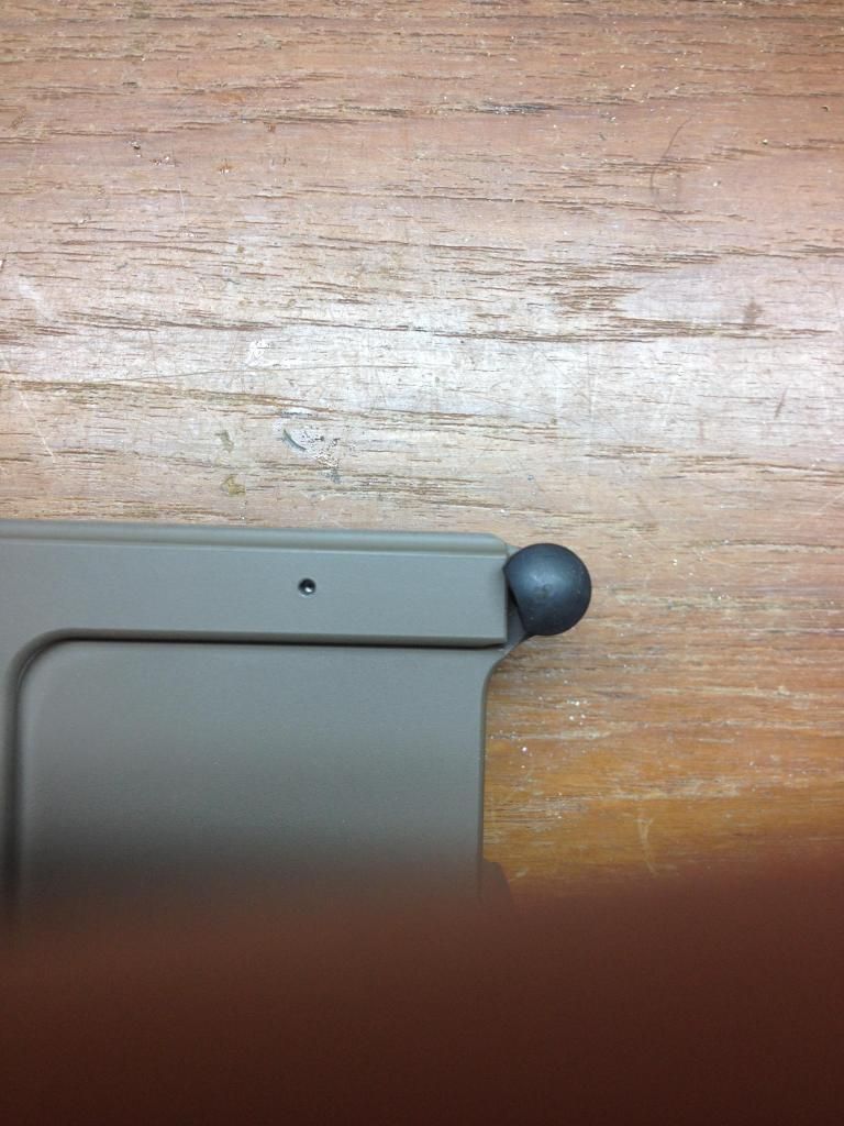

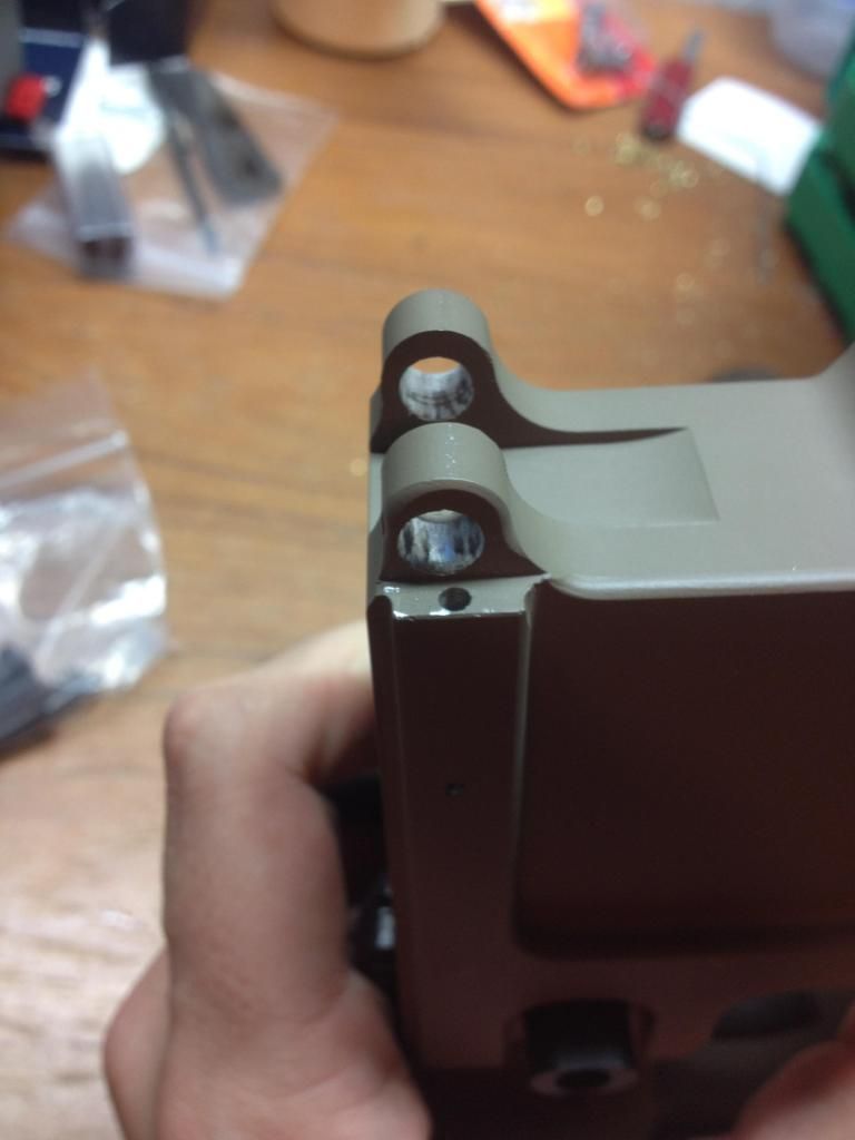

    Problem 4: front takedown pin. again we have an issue with the dentent hole being off center. It should be drilled in the "center" and at a 90* angle to the takedown pin hole. but it is slightly off, causing the pin to sit at an angle. which in turn does not allow it to fully pin the upper and lower together.
    is your lower anodized? this may be an issue. run small drillbit (by hand, not powered) through the bolt catch roll pin hole. this usually fixes that issue.
    need pics for this one please

          These two photos show the front takedown...hopefully what i was saying makes more sense now.
          Here is the bolt catch/release. The problem now is that i pinned it in place. and it cannot be tapped completely through to remove it. I guess it would have to be drilled out.
          As you can see the lower was cerakoted. which is rather thick. i filed down the areas where the fire control pins and take down pins sit. i didnt touch the bolt realease hole. which may have been a huge mistake.

                        I can't believe someone thought it was a good idea to make a blind hole for the bolt catch roll pin.
                        How the f are you supposed to get that pin out?

                          Originally posted by m16
                          Yeah, but when you need a mallet to close the receivers it might be a little too tight haha
                          THANK you. As soon as i tapped it in i realized it was only going in and not out. Immediate regret on my part. and a few choice words...

                            I saw the front take down pin and laughed my ***** off, sorry, just looked so wrong. what I would do is dermal down the takedown pin it's self so it sits flush with the lower, the bolt catch should be abled to be hammered out and redrilled as well. Good luck

                              • 1227
                              I'm wondering if it was the cerakote that added a small layer of material to make everything fit too tight. Most 80% lowers I've worked with needed a little persuasion to work right. Not quite as bad as you have it but small issues.
