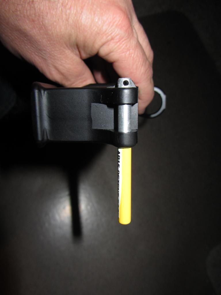

              I made this..................
