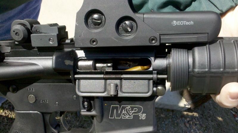

                .223 PMC - Start of the day 90% of the time the next round did not feed from the magazine. Last round did not open the bolt. At the end of the day I shot this ammo again. The round did get pulled from the magazine but the bolt did not close (like this, but this is not my rifle)
