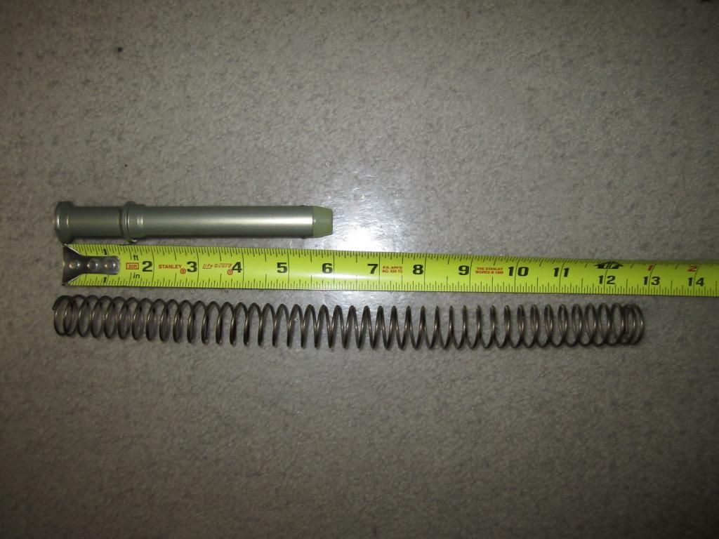

    spring and buffer I am using.....

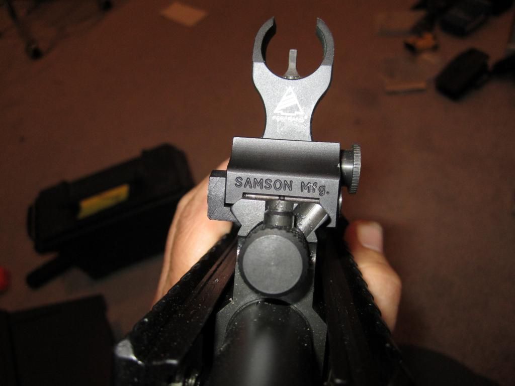

        Do you have an adjustable gas block? Pistons do not have an adjustable gas block. The Ferfrans has 4 different settings.
        9:00 o'clock position to disassemble
        12:00 o'clock normal shooting
        1:00 o'clock suppressed
        3:00 o'clock single shot
        I was shooting at 12:00 position

                    So your gas block, that is not adjustable... has settings to adjust it's operation.
                    Riiiiight...
                    So what's that adjustment knob on the front of the gas block for again? Also since you know so much about the adjustments that your gas block supports, what buffer tube are you using(since I'm not seeing this listed anywhere).

                      a PISTON upper does not have an adjustable gas block like a DI upper does. A DI gas block can be adjusted for each load you are using. A PISTON upper has ONE setting to shoot at UNLESS you are using a suppressor or want to shoot SINGLE shot.
                      I posted a picture of the spring and buffer next to a tape measure. So you must realize that that spring and buffer will not function in a positional Buffer tube for an adjustable stock??
                      here is the one on it...

                          Yeah, the buffer isn't letting bolt cycle far enough back to lock is all I can think of. Try a different weight buffer? More compressable spring? Different gas block setting?
                            So basically what you're saying is, that your gas block is adjustable.
                            Yes.
                            http://www.brownells.com/rifle-parts...prod24086.aspx
                            Well it's not like we could be sure whether or not you knew that since you're telling us that your adjustable gas block isn't adjustable.

                              I really dont think you understand how your firearm works if you think that isn't an adjustable gas block.
