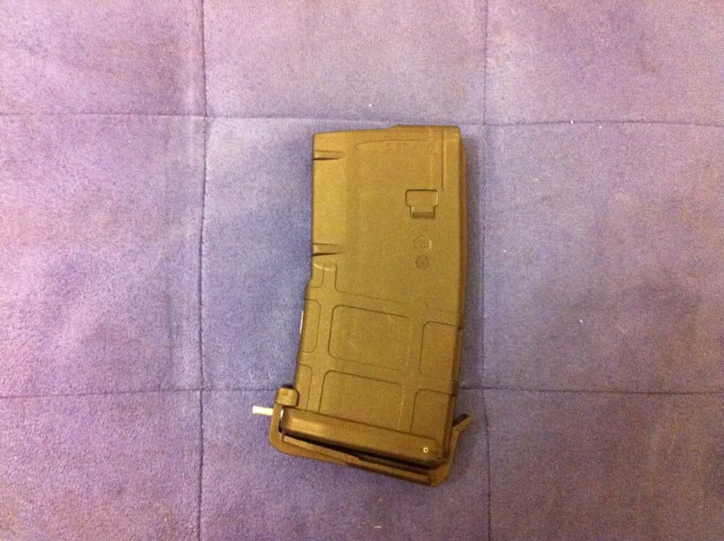

    I was lurking the other mag-lock thread and wanted to give folks a simple and free (most likely) solution for their CA mag-lock equipped AR-15's. Here's what you'll need:

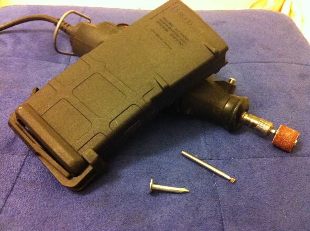

    -Gen 2 Pmag w/ dust cover
    -Roofing nail
    -drill w/ bits
    -dremmel w/ grinding bit

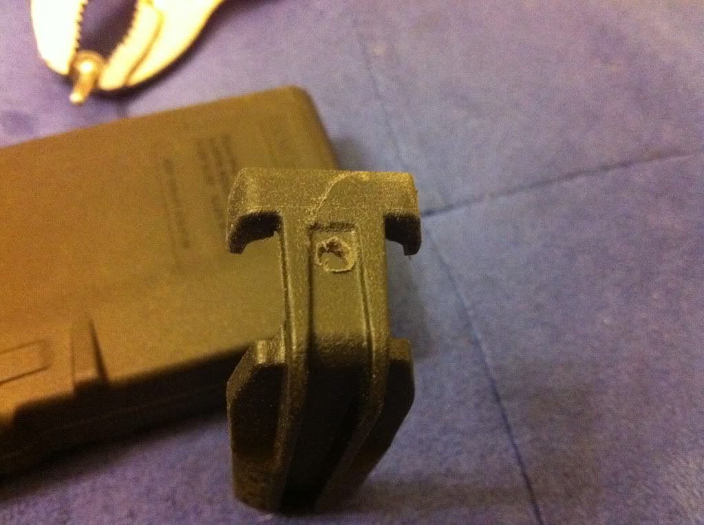

    You'll be drilling a small hole in front of your dust cover that will hold the roofing nail snug. Here is where I drilled:
    (Dont mind the bit walk mark)

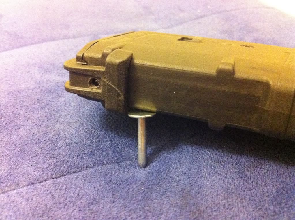

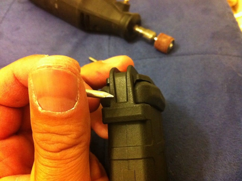

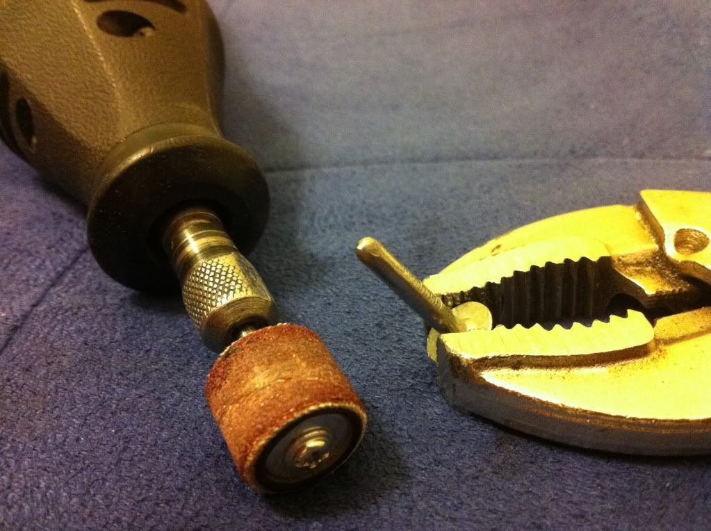

    Trim and round off the tip of the nail. The length will be determined by how deep your mag-lock hole is:
    Boom! Non-permanent FML (Free Mag Lock) Tool.
    Take it off for pics lol!
