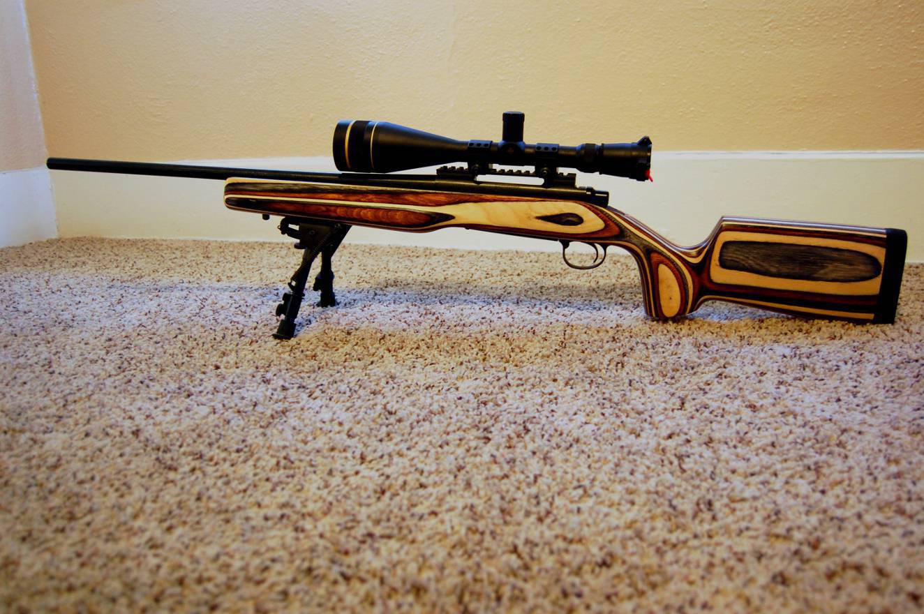

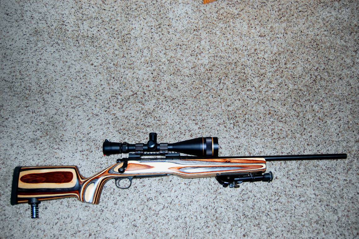

My Rem 700 in 6.5 Swede + machined a Monopod
  • CobraRed
    • May 2012
    • 1018

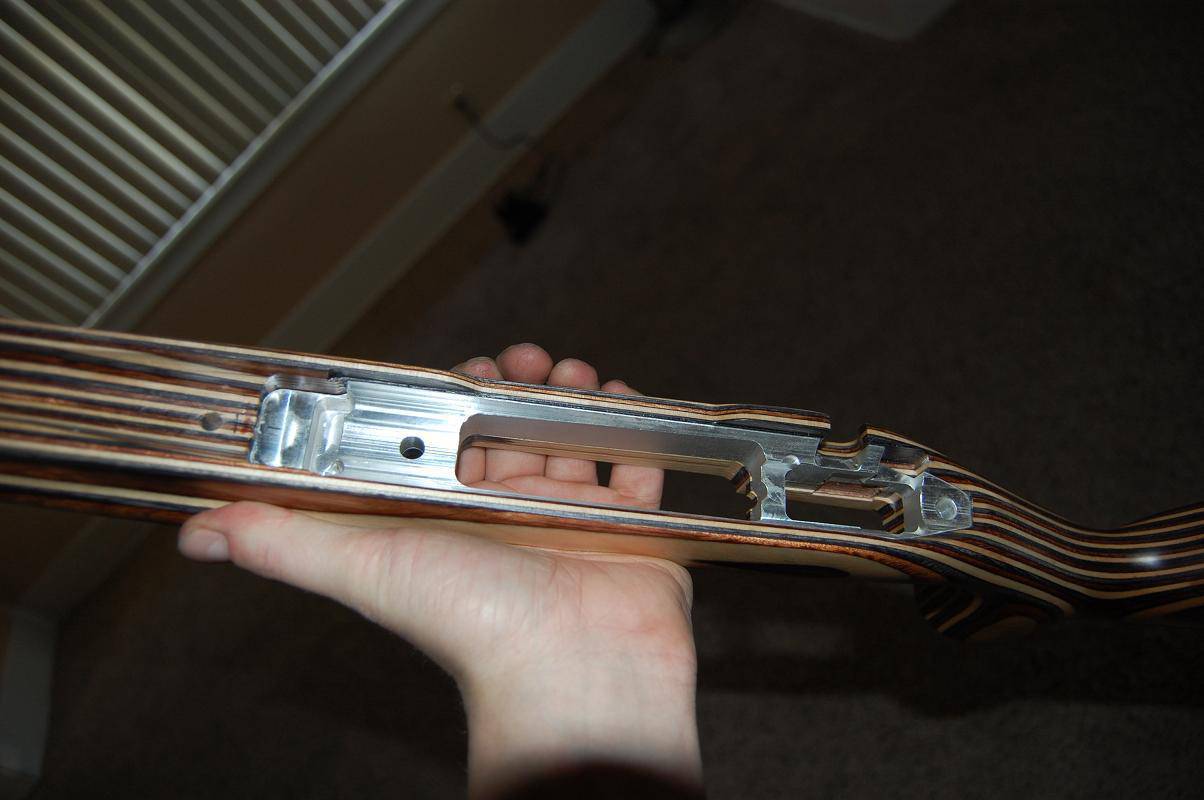

    Picked this 1994 (only year it was made) 700 in 6.5x55 from a fellow calguns member in original trim. Fitted a Bobby Hart birch accublock stock plus the Leupold 6.5-20x50 and a bi-pod. A heavy McGowen 28" 1:8.5 twist cromoly barrel is on order (my third from them).
    I also machined/milled the nightforce 20 moa base length down to get rid of the "surfboard" on the end and allow the scope to sit further back in a comfortable sight picture to cheek weld position.
    Since my other long ranger is all tactical looking and I shoot in the desert areas a lot I thought this stock would be a nice fit.

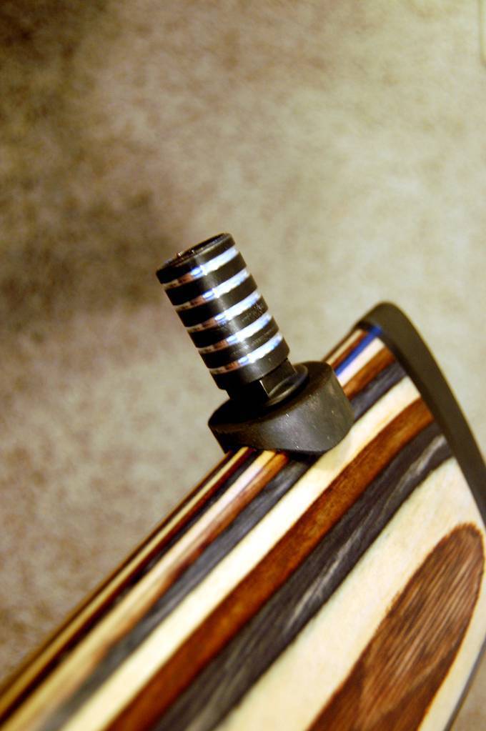

    3/26 update
    Made a monopod out of aluminum and stainless and neoprene to fit snug against the stock. Used the taped hole from the sling stud. Extends about 1.5" from the starting point. 13 rotations per inch

          But I do not understand the fascination with aluminum bedding blocks. If you do even a simple search on the properties of materials, aluminum is about the worst thing in terms of expansion due to heat. And the best ? Who would have guessed. Wood.
            Factory Lapua and Norma ammo is plenty hot. So is Federal and was Speer.
            Oh I know all about alloys. My job is tracking and ordering thousands of different materials and alloys for aircraft parts machining. But on the list of top attributes for a stock, its reaction to heat i'd imagine is pretty low.

                  ...But I do not understand the fascination with aluminum bedding blocks. If you do even a simple search on the properties of materials, aluminum is about the worst thing in terms of expansion due to heat...
                  Yes but it is a closer match to fiberglass that was the original stock material for bedding blocks.
